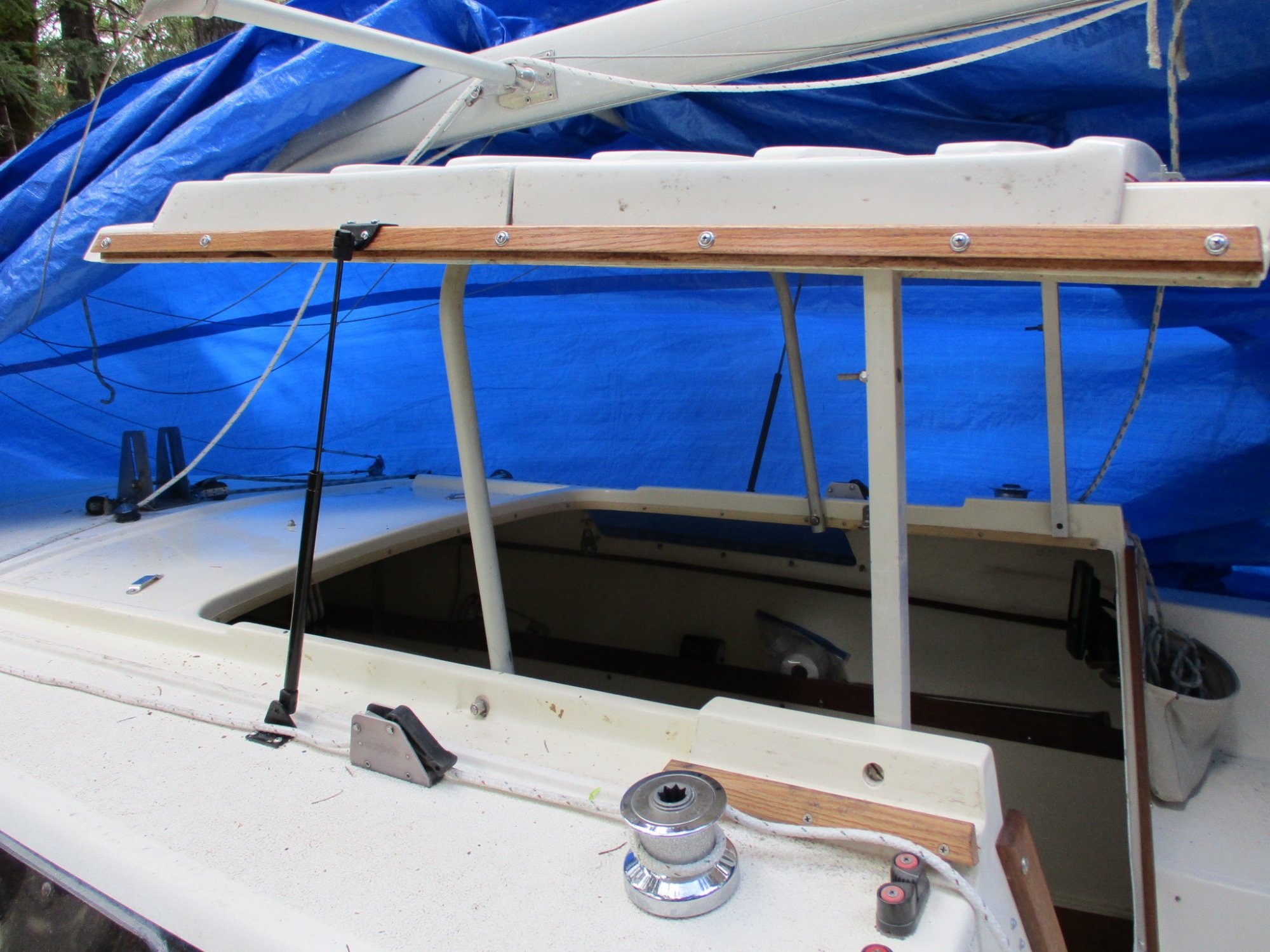

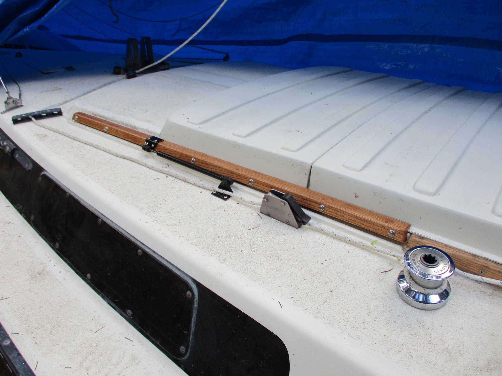

High on the priority list was installing a set of 60 lb gas struts under the pop top. I did this on our Mac 25 a few years ago and now can't imagine owning a pop top boat without these struts. it makes it SO much easier to hoist that bloody thing for my 99 lb wife, as well as this 220 lb old man ;) there wasn't enough room under the top for the struts, but outside is ok also I recon'. it works the same. no more need to fumble with those steel strut support rods wile holding the top up with your head, etc etc.:)

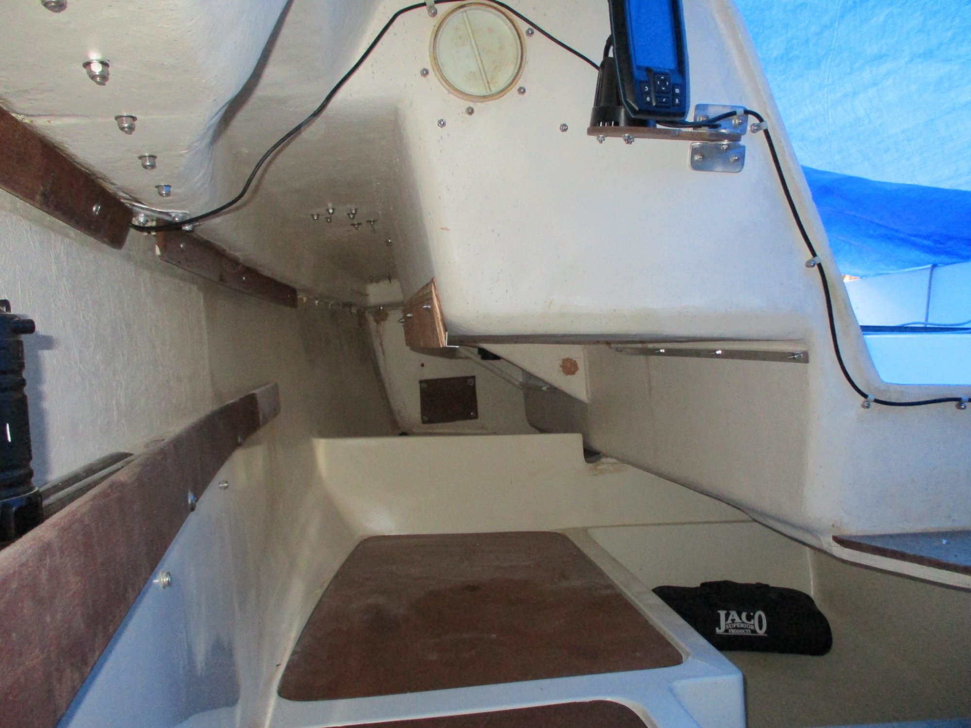

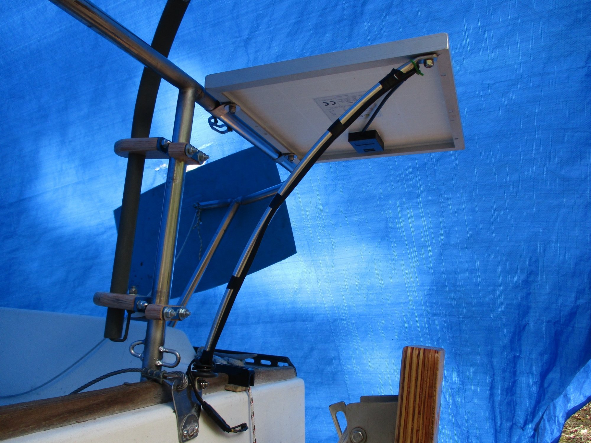

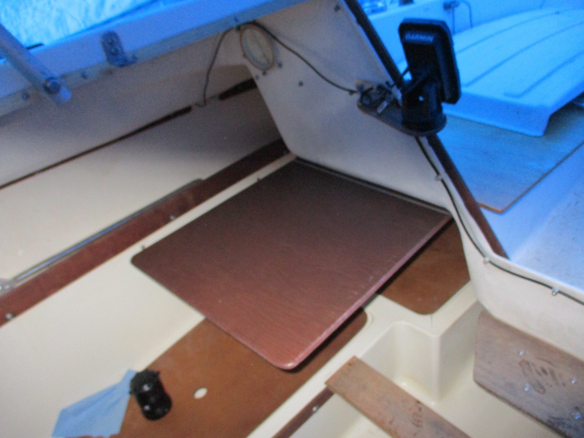

Last fall I had installed a small ATV winch inside the cabin to take over the duties of raising and lowering the (600 lb) lifting keel. part of that installation process included adding a garden tractor size battery, which also operates a small Garmin fish finder/sonar and an led light in the cabin. low demands, but sill requires periodic battery replenishment, so I've added a 20 watt solar panel off the back railing and a charge controller behind the cabin table. no more need to plug in a charger every few days/week on the lake.

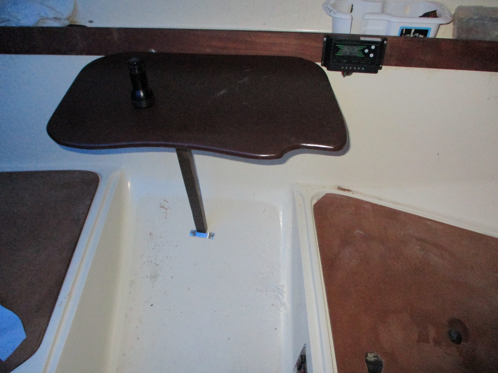

The new (small version) folding table gives us a lot of extra room to move around in the cabin, but also eliminated some "kitchen counter space", so this new slide out counter top solves that issue and takes away zero cabin space when not in use. it should work out well for food prep and to set our single burner propane stove on.

Of course it depends on the weight of the hatch, as well as how effectively the angle is set up to give the best mechanical advantage, so some guesstimating may be required for each application. but.... that being said ;) check on Amazon, as they have a very wide selection of strength and length gas struts to choose from. on our Mac 25 I used (2) 90 lb struts, 20" long when extended. for the Merit, I used (2) 60 lb struts 18.5" long. both sets have about a 7.5" stroke as I recall. I spent a lot of time with a piece of dwell rod and a tape measure, wile raising and lowering the top, to better visualize where best to mount the struts. measure ten times and mount once is the word of the day here :).
here's a pic of the struts as mounted on our Mac. note that sometimes you may have to make concessions, and this is another good case of that. because the available mounting space was very limited I could only utilize about 2/3 the struts travel, which is why I used the 90 lb struts on that one. not as good of mechanical advantage meant a stronger lift strut was needed. I guess I got a little lucky, but both mine worked out really well on strength, but the struts aren't that expensive if you do make a major error. they average about $15.00 each + a couple bucks for the brackets.
