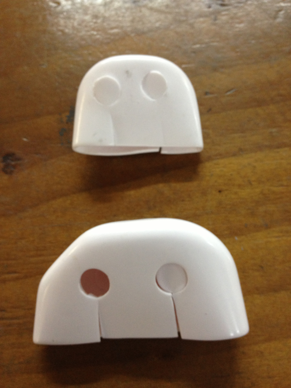

I need to replace my spreader boots and do not know the width of the upper and lower spreaders. Does anyone have the width of the spreaders or, if you've replaced your boots, what size did you purchase?
I made my own boots out of leather years ago. See the attached drawing that I made and used for a template. The 3 3/4" segment wrapped half way around the spreader and when I folded the template around the shroud there was another 3 3/4" segment to wrap around the other half of the spreader. So if the circumference is 7 1/2", I estimate the width would be aproximately 3" to 3 1/2".
A correction and mea culpa. Just went through a truck transfer of my 310, number 293, and just did the re-stepping. The spreader boots for both sets of spreaders are the smaller BF3s. The mid-size BF4s are too large. Sorry I put out the wrong info earlier.
