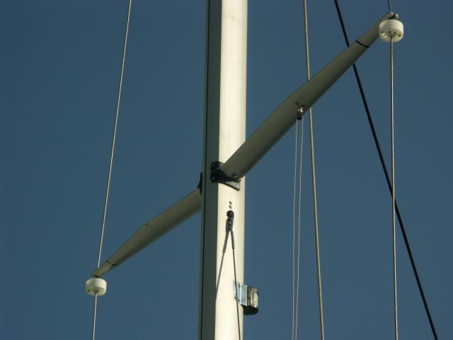

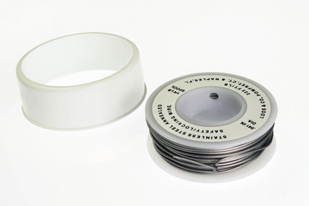

The spreaders should be held in place by the bracket that attaches them to the mast. The wire will lay in a groove on the spreader tip end cap, which should be a non-metallic piece. If your boat has a metallic end cap... you can try to find a matching one from another source (you might call rig rite) or try wrapping rigging tape around the fitting, or coat with an anti corrosion product like "tef-gel". In any event... you must use stainless or monel seizing wire to secure the shroud to the end cap. There will be a set of holes in the spreader to anchor the wire before twisting it around the shroud.
I've pictured a few of the parts for a catalina 27 below... You may need to check the ericson owner's site for specifics.

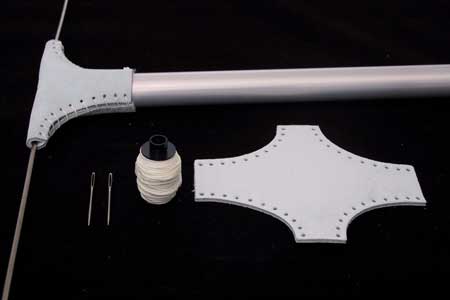

Finally, don't forget to cover the spreader ends to protect your sails from abrasion. There's a number of products in this area to choose from.

On my boat there are stops swaged onto the shroud just below the spreader tip. The bottom of the spreader tip rests on the stops and cannot drop below that point. It maintains the proper angle between the spreader and shroud. I use rollers mounted on the shrouds to protect the sail. They allow the sail to roll over the spreader tip with very little friction. It's also a good idea to install spreader patches on your sail to prevent the sail fabric from stretching or worse, in the event someone forgets to release the sheet while tacking.
