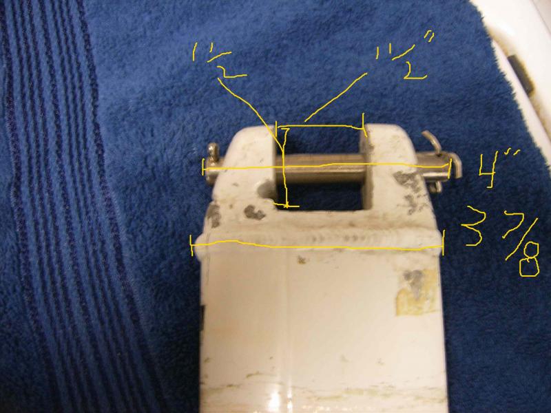

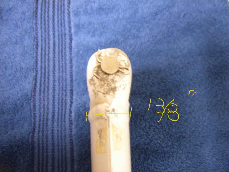

New boots are a winter project for me. I have used a home made set made with rubber from tile baseboard and duct tape- then covered with white tape. I have one spreader at home- they are all the same size at the end. I can take measurements for you if you need them- let me know what you need. I am contemplating using the materal from an old fender (white) for new ones but have not made the pattern yet

Yes, I would very much appreciate knowing those measurements. No plan to take the mast down this summer. Thank you.

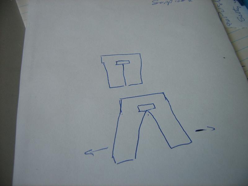

Thanks Splax- born of 12 years of taking the mast down each fall and putting it back up each spring. You could put boots on with the mast up if the boots are split on the top and bottom so you can open them and slide them on from the end of the spreaders. I have attached a crude drawing. The view in the drawings is from the top or bottom- the wider flat side.
