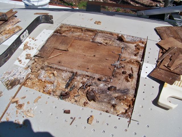

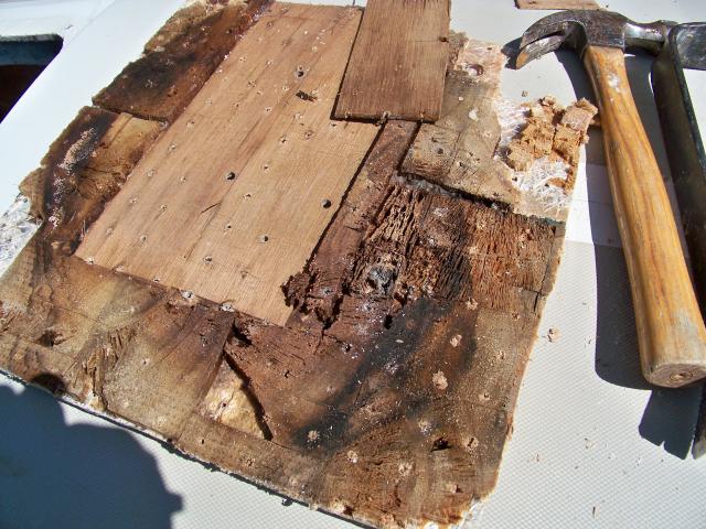

If the core material is not balsa, or perhaps, a mixture of the two, then it might as well be. No, drilling bunch of holes and squirting the substance of your choice will not work any better than ignoring the problem, which is an option if you do not get too far from shore....if you want you can check out the threads on my repairs by looking under the statistics in my profile page. Try the forums "trouble with tabernacles" and "cutta hole in my boat" .
it is time to bone up on don casey's " This old boat", and get to know the helpful tool man at Sears, and this forum....
it is going to look something like this....

I think that it's important to find out where the leak originated. The only way to do that is to take off the top layer of fiberglass as Keith did and dig out the rot. The leak could have started from a cap rail screw hole in the fiberglass, the bow pulpit flange, or any type of hardware on the forward deck.
Pick up Don Casey's book on Fiberglass Repair entitled, "Sailboat Hull & Deck Repair" or "This Old Boat." These books may be found in your public Library. Use a top brand of Fiberglass Epoxy resin with a good core material. Don't use Polyester Resin. Epoxy won't absorb moisture. Polyester resins will.
