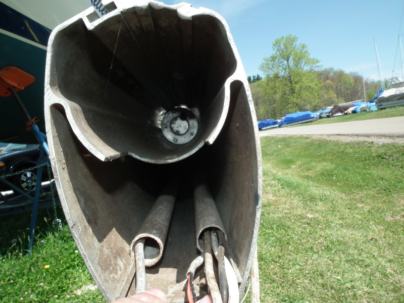

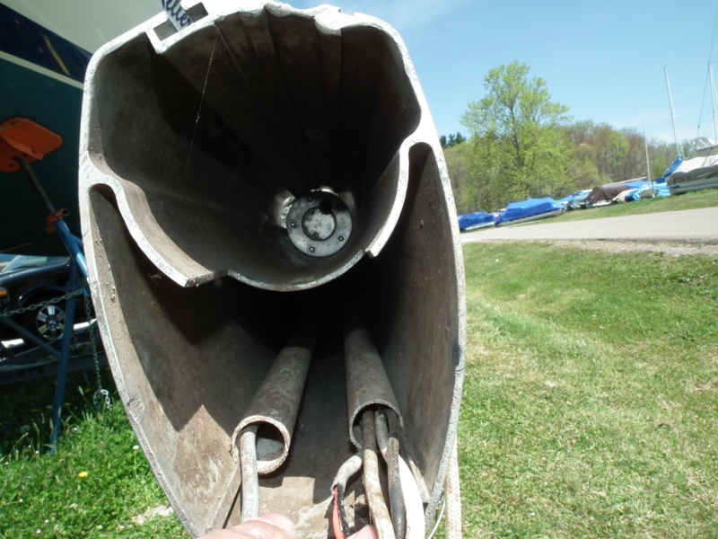

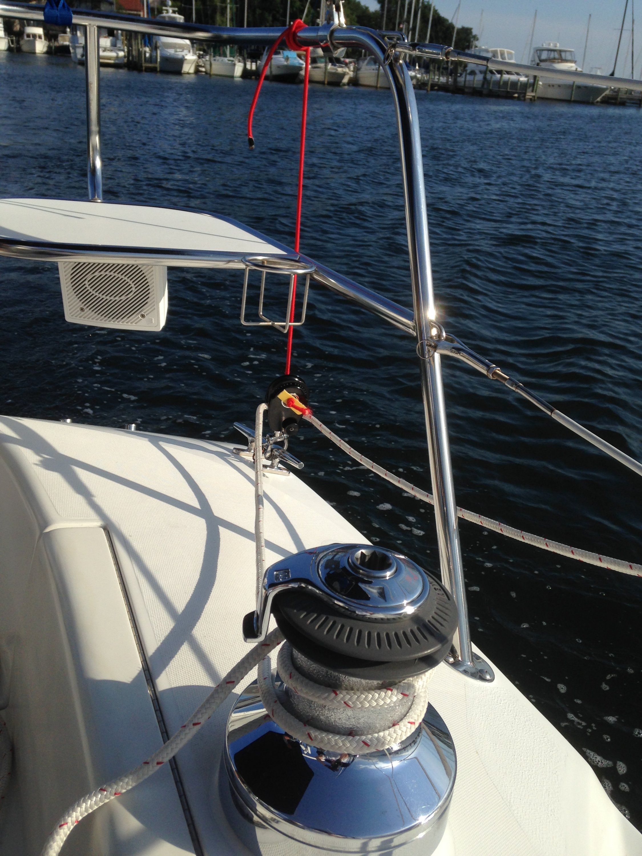

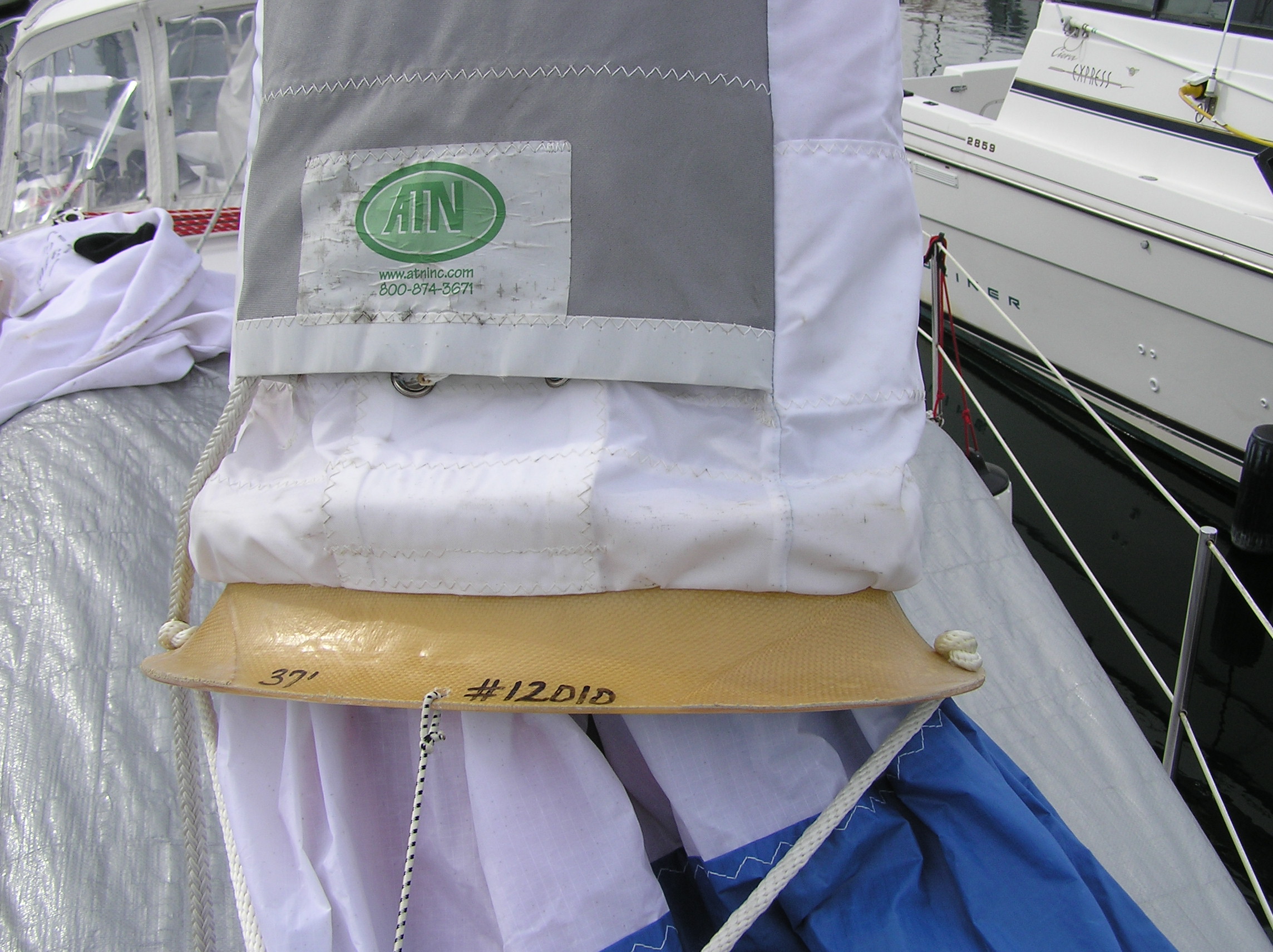

I have a 155 Genoa and use a pole that extends to 18 ft. I also have an asymmetrical spinnaker. I use whichever seems appropriate for the conditions and wind angle. I won't fly the spinnaker single-handed with the wind above 10 knots. In those conditions I use the Genoa and pole. When in one of the fun club races, (I don't do serious racing) I'm never in the spinnaker class so the pole comes in handy with the Genoa. For the chute, I run the asymmetric sheets through snatch blocks on the rear cleats. The bungee keeps the block from whacking into the deck.

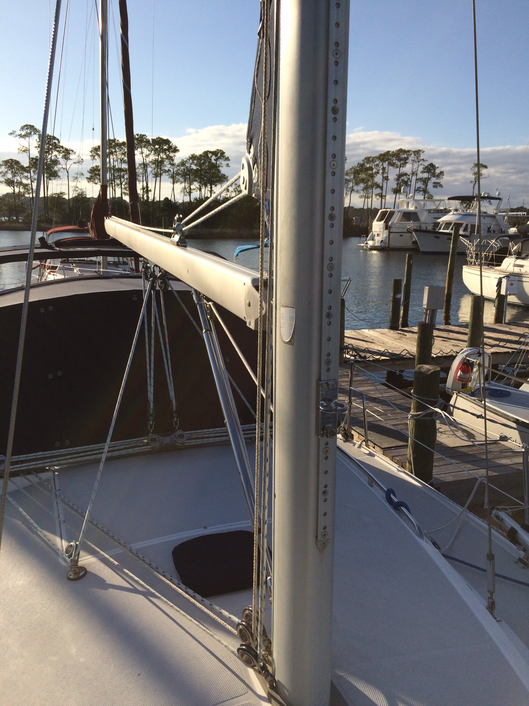

It is easy to put a track on the mast with a ring. If you have a furling main, the attached picture shows the mast cross section. You will be drilling between the two PVC conduits. I tapped the holes and put in the track with flat head aluminum screws. I used four feet of track for the ring, but I think 2 or three feet would work.
