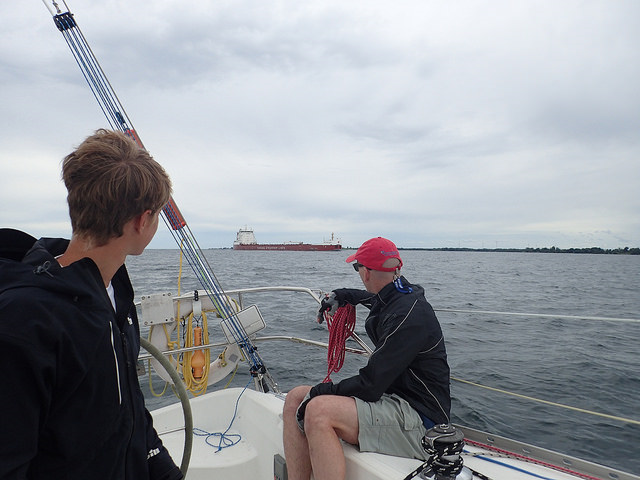

If your backstay is split around the walkout transom, and then rejoins the single backstay 8-10' off the deck, then that is the same as mine. I added a Johnston backstay adjuster
And then used fairly small Harken triple blocks, one with becket, and one with a cam cleat. One end connected to the backstay eye on deck with a short pendent, and the other to a length of amsteel that runs up and through the middle sheave on the Johnston adjuster and back down to the other backstay deck eye.
That provides a base of 2x * 6x =12x power on the block system, and when combined with the physics of the johnston backstay adjuster, I get a resulting ~200:1 down to ~150:1 (the further you pull it down, the less power you get).
I can go from a straight mast, with a barely tight backstay to very aggressive bend (1-1.5 mast sections worth or more) with very little effort (and a moderate coil of ~3/16 line !).
Here's a picture where you can see part of it:
