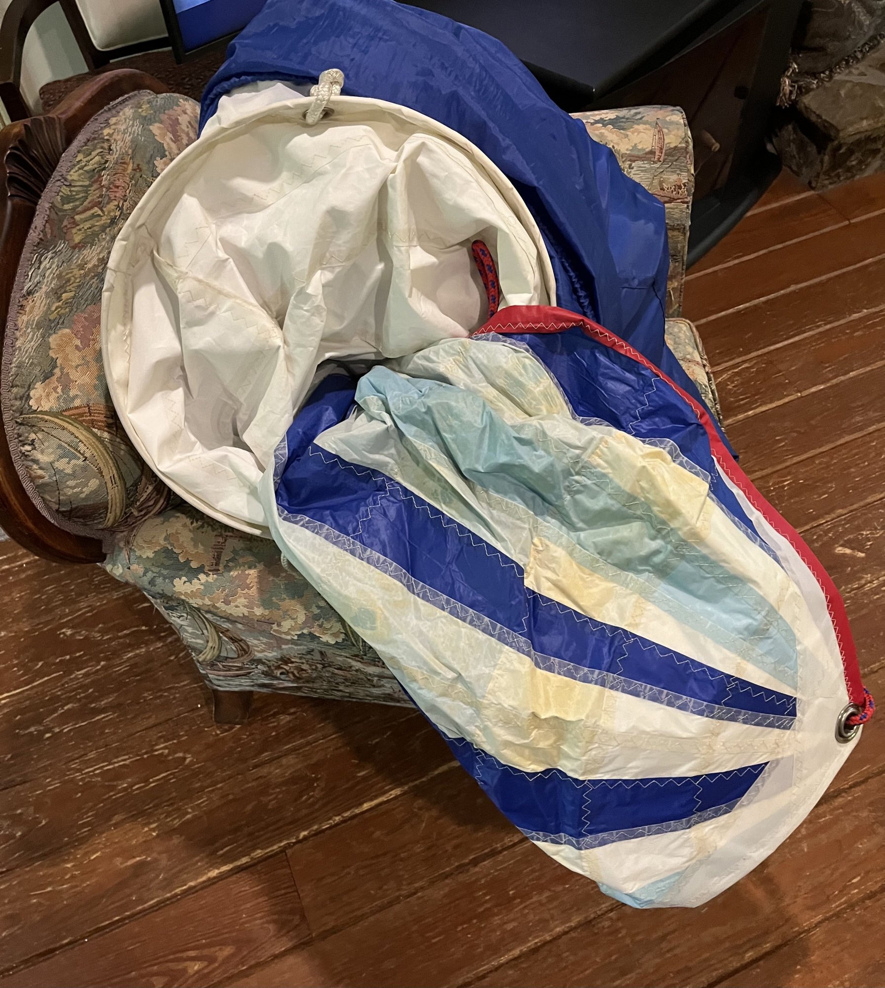

He loaded us up with some of his home made wine, bananas from this trees, and boxes of boat parts and accessories. One of these bags was reported to contain a spinnaker. I was taught that you tell people that you have a spinnaker but under no circumstances do you ever try to fly it. After a year and a half of reading I decided that with a spinnaker sock the setting and retrieving of the sail is made much simpler. I just opened the bag in the living room to measure the sail for a sock and discovered that there was already a sock around the sail with all the necessary lines! I am now weeks and dollars ahead of schedule.
Spinnaker with Sock.jpg I would like to move my old jib halyard block above my furler but since there is already a block on the mast head I will use it. I will have to add a block somewhere on deck or the front of the mast to bring it to the old jib cleat. Photos will follow.

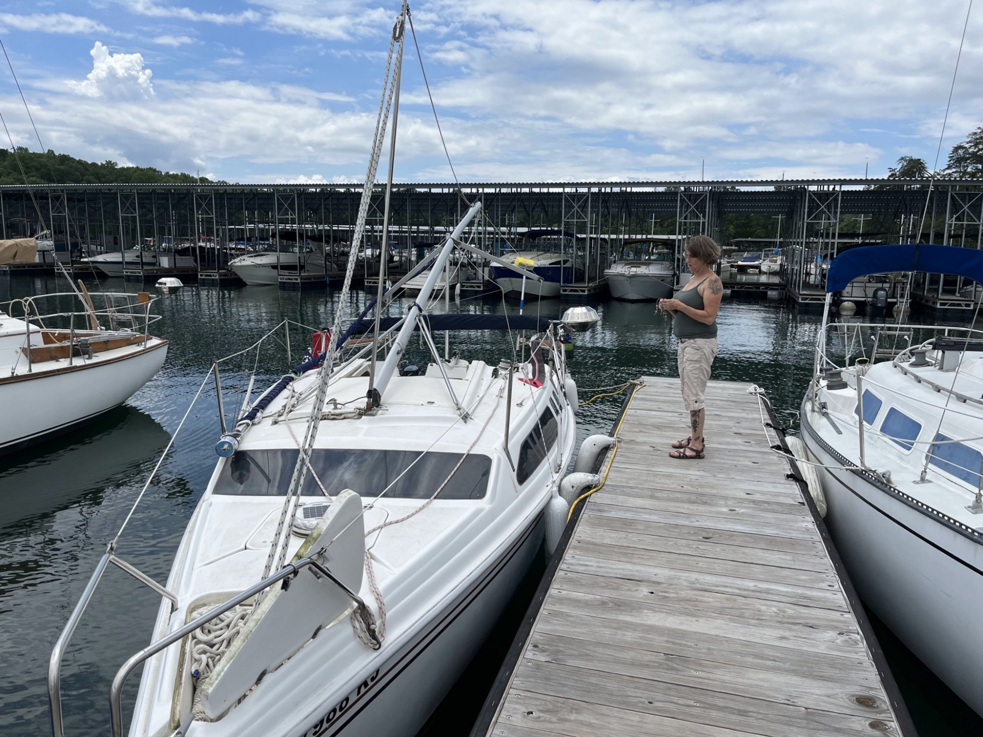

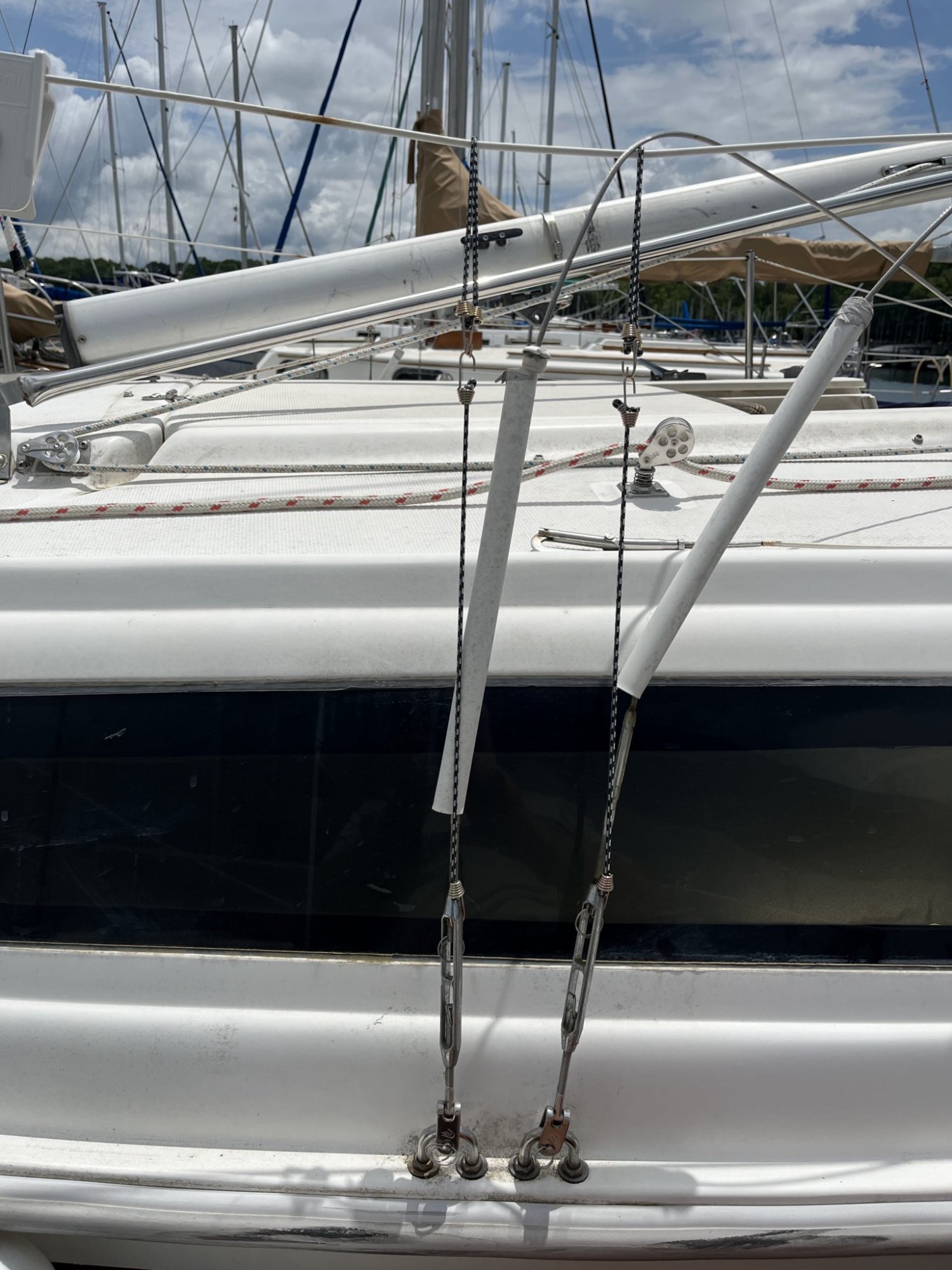

Jessie and I dropped the mast yesterday. We then pulled a light nylon line through the spinnaker halyard block above the forestay and tied it to the halyard block opposite the boom on the mast. I had thought that the block was on the mast head but it was below it. We had removed the boom and the sail together and set it on the dock. It was the first time we had dropped the mast with the CDI Furler system. It wasn't as cumbersome than I feared. I followed the recommendations from others and used small bungees to hold the turnbuckles upright and taut to avoid bending. That worked perfectly. Spinnaker halyard is on order from this site.
