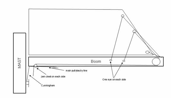

I cant help on the full spinnaker question - I use an asymmetric and love it. I have an 81 H25 and the reefing on the main is layed out as follows: 2 reef points in main Two reefing lines running through boom to cam cleats on mast end. The reefing lines should come over the sheaves located in the aft boom cover and up through the reef points then down to an eye on the boom even with or a little behind the for-aft position of the reef point. I will usually only set up one point unless I know the weather will be highly variable. With such a small main the extra weight can disturb sail shape. I love my h25 and sail it year round in the Northern Neck of VA
