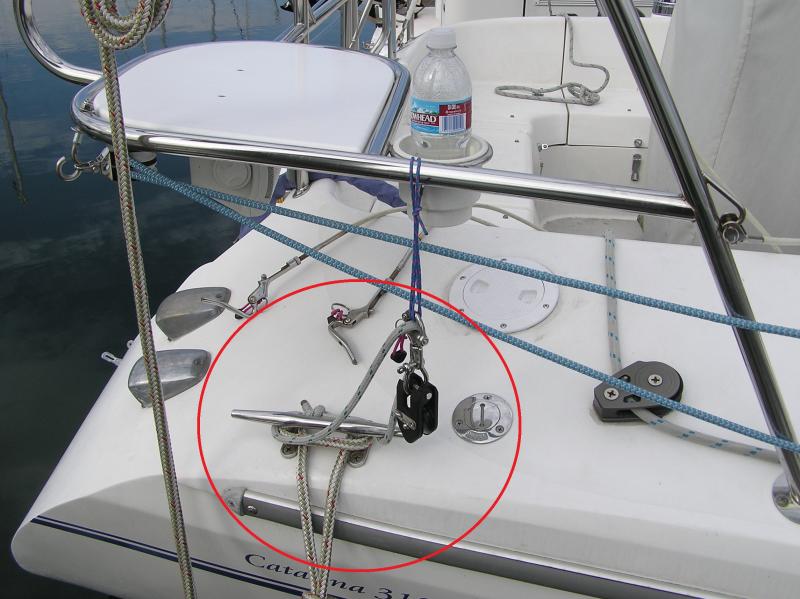

My setup for my asym......I call it a twing.
Its not a twing but it's a good solution. Getting the sheet back will pay off.
I'd think about replacing the thin blue line with shock cord, so it is sure to never bear the load. And you probably would be able to replace about 150 bucks worth of stainless with 4 bucks worth of dyneema loops.
When I talk to the 1st mate I would say hand me the twing and she would hand me this twing.
The twing is stored on the dodger using the blue string.
I use the basic twing for a lot of things......including sheet lines what ever they are.
The picture showing the twing ..........is not how you would install a line to a cleat with a block attached......I would install the line like you see the aft deck line is installed to the cleat.
I do not have a picture of the twing being used on a sheet line but maybe you do and can show everyone how you use a twing.
Thanks for being observant.......seems pictures are worth a thousand words sometimes.
