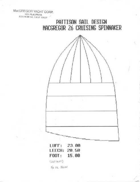

I have a copy of the 'cruising spinnaker' for the 26. (asymmetrical)
http://i64.photobucket.com/albums/h169/ftldiver2/MACGREGOR/sail4.jpg
luff 23, leech 20.5, foot 15. -I think it would work.

I wonder if it would work on my V25? Where can I find the sail dimensions?

Here is the spin size for the 26D & S.
Don't know ware/who I got it form. Thanks whoever!
