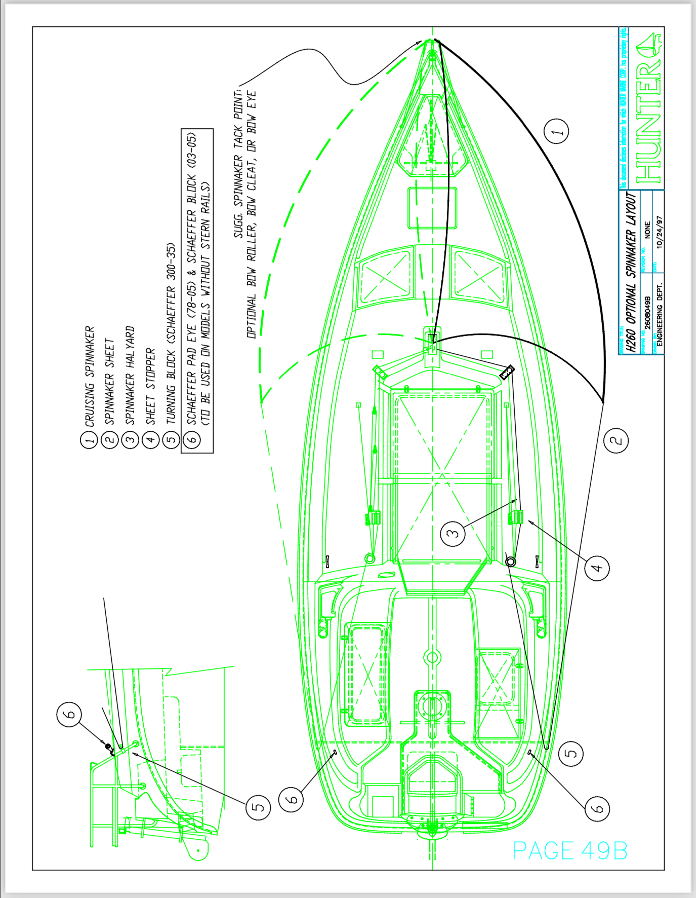

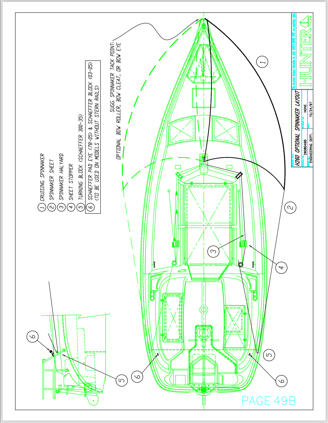

Regarding sheet handling, my boat had stern pulpits with the seats. The common H260 approach in that situation is to mount a rail type block (Schaefer) on the pulpit stanchion and use it as a turning block to lead the sheets to the cabin top winches. The attached from the manual does show a pad eye mount in lieu of the stern pulpit use.

Which mast mfg do you have. You probably have the US Spars mast. Then call them as they are located in Gainesville Florida
Generally the sail manufacturers have the information. Keep me updated
I did note the backing plate information is posted which are aluminum plats encapsulated in the deck are shown. Look at the suggested way to run the lines

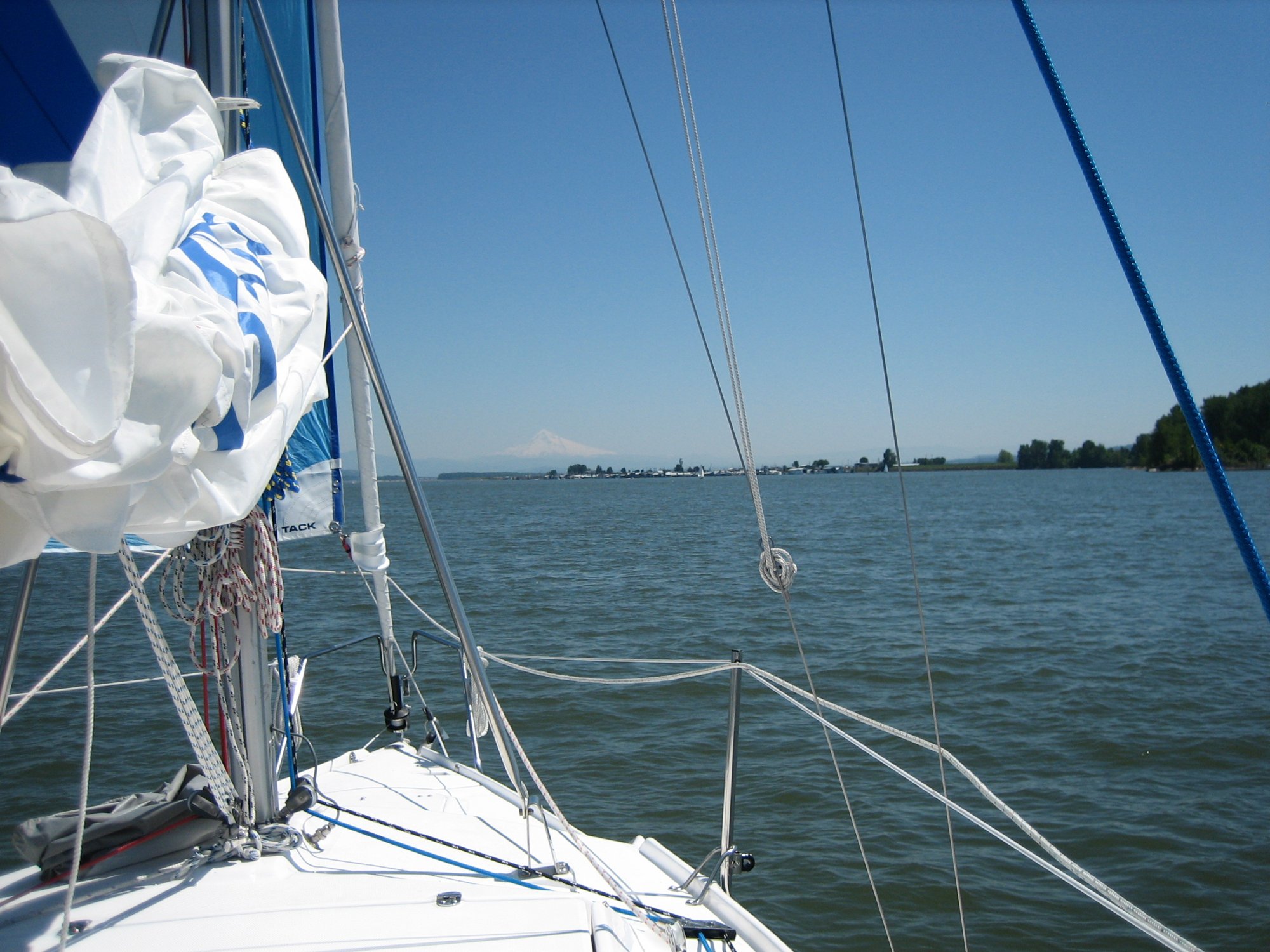

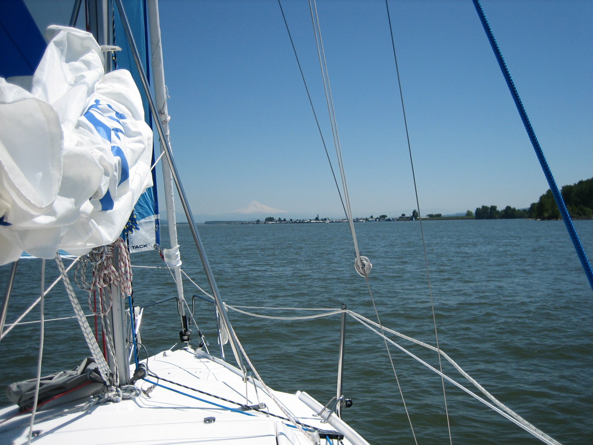

Regarding the tack line, we had an anchor roller on our boat that had a bail over the end to keep things in the channel. We ran the tackline down the starboard rail to the bail where we had a turning block equipped with a snap shackle that fit onto the bail. From there it ran to an ATN Tacker that was a plastic like sleeve that rode over the top of the furled headsail. The free end of the line was typically tied to the stanchion at the clutches or the nearby cleat. This allowed adjustment of the tack for wind and points of sail.
The attached image illustrates the setup. The bail, turning block and tacker are evident.
