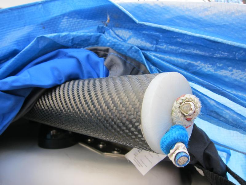

I'll try to uncover my bow this weekend and get you a picture-You could also ask SBO (here) if they can get the part.
Mar 20, 2004
1,753
Here it is-it's a delrin plug machined to fit in the tube with holes for the retract line and the guy. hope this helps.

I discovered that the plug has been pulled inside the end of the tube about 4 inches. I am going to try to push it back out with a long piece of PVC pipe with a bit smaller diameter than the tube. Then I will saw off the frayed end of the tube. My only question at this point is how the plug is retained at the end of the tube. Maybe its a friction fit, maybe it's glued into place. Any ideas, suggestions?
Nov 8, 2010
11,386
Something is very strange with your pole. That cap should be wider at the end (matching the outside diameter of the the pole), and not be able to slide any father inside the pole. Not sure how it got where it is now, but is is unlikely that it has any useful adhesive, based on it current position.
I'd try and ram it out, but worst case you could cut 6 inches (behind the plug) off that pole and still be OK. Actual pole length on that boat is not that important.
