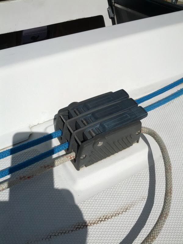

Looks like a press-fit. Is it stacked side-by-side like the ones in the photo?

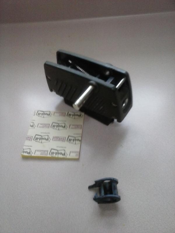

Done this many times. That pin DOES come out. Use a hammer and a drift pin to hit the pin and not the base, which WILL crack if you abuse it.

It's a single and I have it sitting beside me. So just drift the pin through.

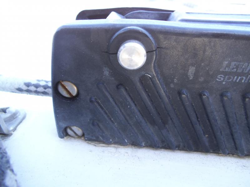

First, if one of the handles has failed, others aren't likely to be far behind. Aside from the aluminum base plate, these clutches are mostly made of plastic. Both the handles and the "side-walls" get brittle with age and fail. See the attached pic of the cracked side plate of my OEM Spinlock. If yours is the same, just driving out the pin to install a new handle won't be a longer term fix. It is possible that one of the side-walls inside of your (double or triple or however many) has failed and you just can't see or have noticed. That said, when mine went bad, I did discover that rebuild kits including new sidewalls are available. And the price at the time was surprisingly reasonable. I don't remember where I found. You will have do your own web search and determine if rebuild is a good choice for you. The Spinlock clutches need to be removed to do the complete rebuild.

Well I got it out and no blood was shed. Thanks Jackdaw. Found a source on-line for just a handle. Ordered from Annapolis Performance Sailing.

Did this a couple of months ago on a dual line spinlock for my 1983 H31. once I got the concept, the work was rather easy. getting the pin out required a punch and hammer while supporting the side plate of the lock. I drilled a whole in a block of pine 2x4 large enough for the pin and the surrounding lip in the side plate. Lined up the pin with the hole, and went at it with a punch and dead blow hammer. The pin came out after a couple of hits. The new lever went in quite easily.

I probably could have modified an old C-clamp and a short piece of tubing and pressed it out.
