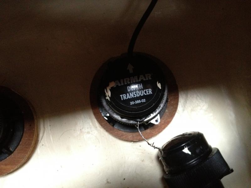

Does anyone here know the type and model number on the speed/ temp transducer on the hunter 33, 2005 model?

If it was the optional electronics package from Hunter installed at the time of original sale its should be a Raymarine ST60. If it was installed by a PO or a separate package offered by the broker it could be anything.
The ST60+ speed/temp transducer works with the ST60 instruments if that's what you need to know.
Magne, unfortunately this is the depth transducer next to the speed/temp but it is made by the same company. Airmar.

Airmar is raymarine. When I replace my gps raystar 125 antenna it had marked on it airmar.

Thank you for answers;) problem with trancducer is now fixed( leaking o- ring)
