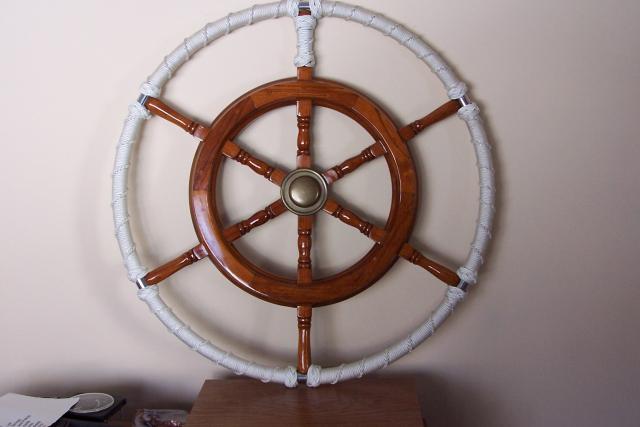

i did the wheel on my boat a few years ago using the same nylon polyester stuff we use for tie down. i think it is 1/8 inch. First, I used a French whipping around the rim and then added the Turk's heads afterwards. I really wanted to make the Turk's heads cover the gap caused by the spokes, but I could not get one to look good covering that large of a spot. With a metal spoke, you can cover the gap.
I used Des Rawson's "Knot Craft" and "The Morrow Guide to Knots" as reference for how to tie the knots This is a good off season project as I think I probably have 30 or 40 hours in it.

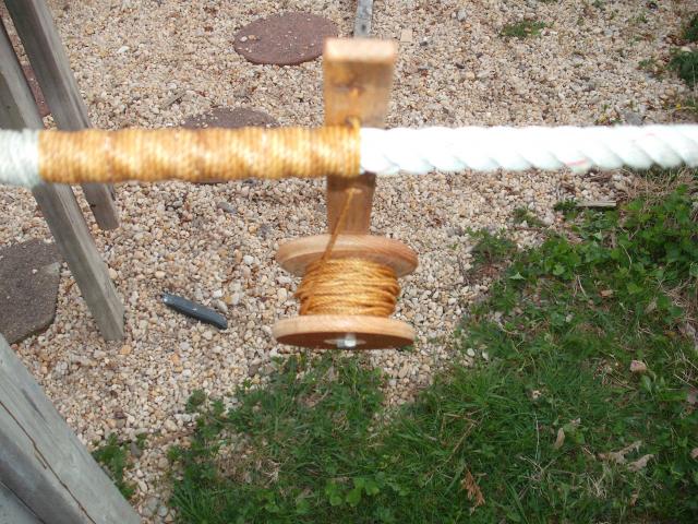

Making a bobbin to hold the twine is a big help. You want one that should you drop it isn't going to unwind a half mile of string.

I french wrapped the wheel and added a Turks head knot to indicate the wheel being centered. Also added two Turks heads where the wheel is when on either tack. This makes steering at night a breeze as you can feel where the rudder is. I can also tell when the sails are trimmed well with someone else at the helm. Takes some of the embarrassment out of sailing with new folks when I can trim the sails and all of a sudden they are sailing great and the boat is moving well.
Took me about 4 hours to do the whole thing.

When considering this project remember that a one ine diameter tube is about 3 1/4 inches around and number 36 twine runs about 12 turns per inch.. That means that a 30 inch wheel will take about 1130 turns or just a little over 300 feet of twine. Finer twine is more turns and more feet. if you use a tool like this it will help.
