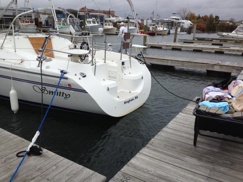

Not the best photo, but you can see the knock off version (Cambridge I think) of the Bose outdoor speakers. They work good. Ok sound, a little base but not great. I don't like the way the PO installed the wires, those are on my list to redo.

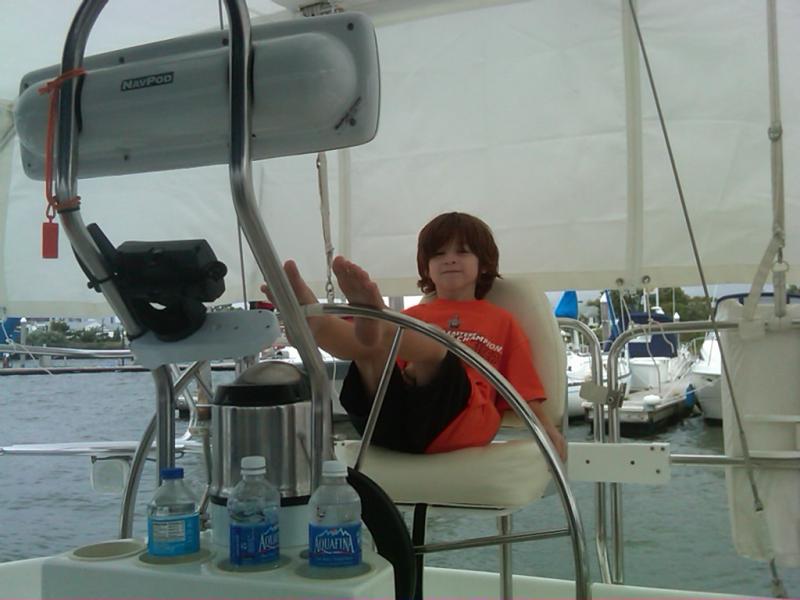

You mean this.....I can see the speakers dieing but the nav pod enclosures under the cat bird seats ?? Why not just replace the speakers they do not have to be the same brand. Here a hint when I installed mine I notice that there needed to be a way for water to drain if any water got into enclosure. So I just drilled a few weep holes at the bottom. If the black grill and housing is showing some where and tear then thats why GOD made paint.
