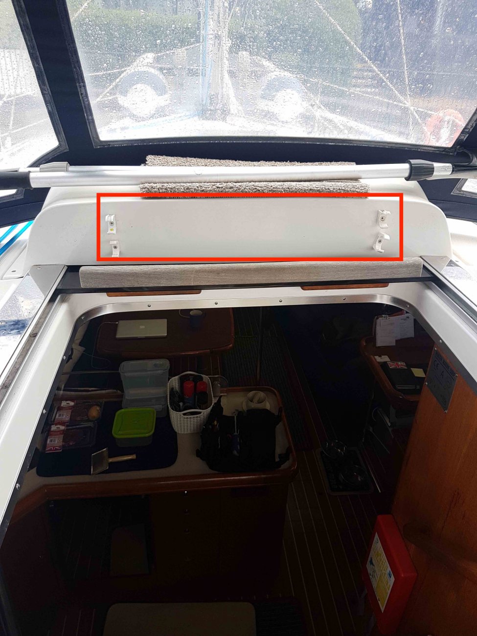

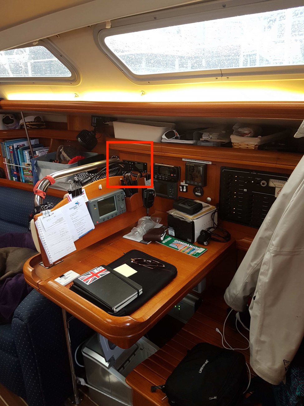

Hello all,
Anyone offer any advice on the best way to run speaker wires from the stereo at the nav station to the raised bit above the companionway in a H41AC. Please see pics and any advice welcome!

It you are lucky, there is some gap between the ceiling liner and the deck that you could work wire through, up to where you want the speakers. If there is a ceiling light up there, you can be sure there is.

I found a bluetooth receiver that plugs into the stereo which gives me music through the boat speakers. Also bought a portable bluetooth speaker, but you may want to buy one that floats ( ask me why this is a good idea :rolleyes: )
I installed a wind repeater in that area above the companionway and ended up taking down some of the headliner. Also have to remove that cover as there are no holes through to the cabin.
