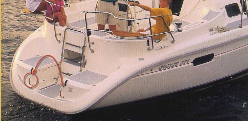

I try to found the handle where it was installed to the end of transom way.
Where we get out, of the water to climb on the boat Is there a way to find the spare pieces for that ?
I don't know why but only one is missing, when I bought my sailboat ( Hunter 336 )
A picture is worth a thousand words! (See picture attached)
Thanks
André

Andre,
My buddy has a 1995 336 and he definitely has 2, as is shown in the picture. The store on this forum is the official Hunter parts supplier. send them a message to see if they can supply the handle. If not it may be best to remove the existing handle and have a stainless welder make a copy for you,
Maybe a previous owner backed into something hard and damaged it.
Good luck.
