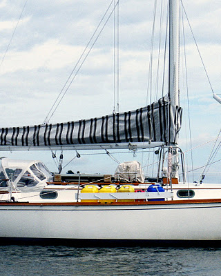

external portable gas tanks should be carried above decks if the laz is not vented.
pretty normal to see big cruising sailboats with several gas/diesel/water tanks on the decks tied to boards between the stanchions.
Some make fancy covers for them.. which helps w/ heat and UV.
