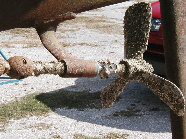

Lol, yes I was out yesterday in 60 degree weather - running in my new engine. I looked at your post and didn't have much to add. I doubt the 37 strut will fit as it is much longer and heavier in build. There is a guy on the site in New Orleans that says he has access to a savage yard of boats. That may be a good source. Or you could take your old one to a stainless steel fabricator - bike shops are good for that - and have one made. stainless steel is strong and will work as well as any casting. You may have to realign your engine after you install the new strut. It depends on what changes are made.
I have had the strut off my Hunter 33. It is a fairly light piece and not as long as the Hunter 37. The shaft on the 33 is one inch. Here is a picture of the Hunter 37 strut that I found. It is nothing like the Hunter 33 strut.

Several commemts. You will have to align the engine after the change. You will need to know the taper angles on the shaft if you have one made.
most times the shafts can be straighened but if they crack you will still need a new one.
usually a compentent marine shop can fab a stainless strut if they have the old one. but that could be a problem for you too. but the shaft has to fit the flange on top and the prop on the other end. length is very critical. to long and it will wobble and flex to short and water will not cool the cutlass bearing in the strut. and you will need a new cutlass bearing fitted to the strut and shaft, and of the proper length.
then after its all together you align run it for 1o or 15 hours and check the alignment again. it OFTEN will change a bit. A perfect alignment will give you no vibration and much longer service to all the components.

Oh and after looking at the picture it seems your shaft pretty much has to be bent. but it also looks very long. unless it is pulled back. The prop looks pretty big so maybe thats why it has a longer shaft (hull clearance). but that makes the prop what to whip arround. not too good.

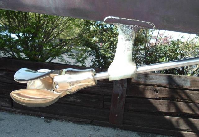

Here's a picture of the H37C strut. This one is a little better than the one in Paul's post. :)

Thanks for a better picture Ed. I got that one from this site in owner mods.:doh:
Jun 2, 2004
5,802
Yea, being bent and with all those barnacles it was pretty nasty.
