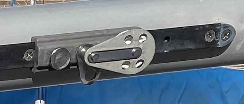

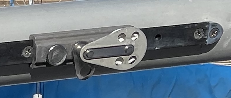

The sheave on this single line reefing clew car fell apart. Most likely age.
Is there a good source for replacement sheaves, or do I have to go to the OEM to get a replacement?
I am not sure of the OEM at this point. Still investigating. And I am assuming I can replace just the sheave.

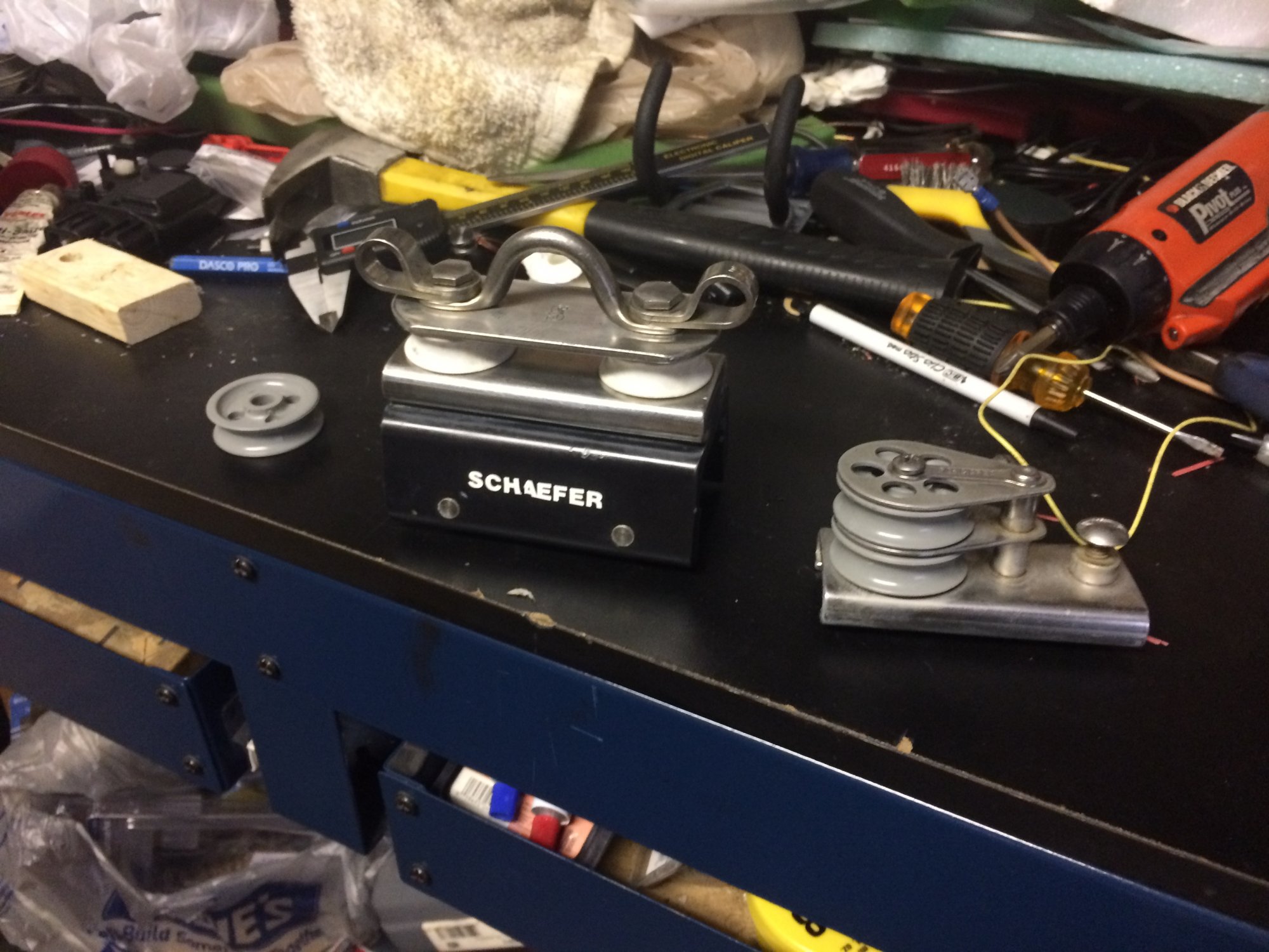

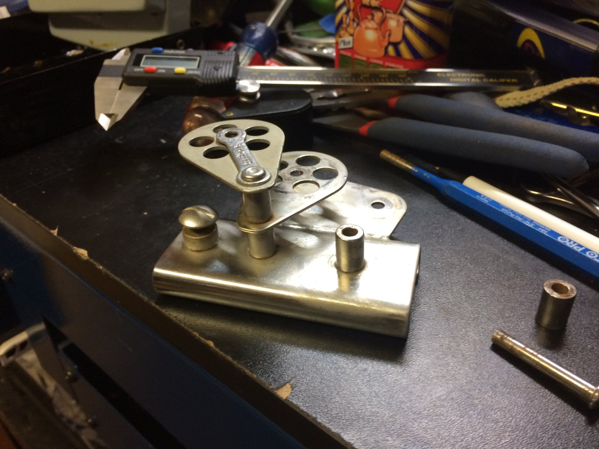

The sheave can be replaced but it is not easy to. You have to drill the expanded end of the sheave axle and press it out. The axle can be replaced with a recessed head shouldered bolt. The pulley hole cannot impinge on any bolt threads The sheave itself is available from Schaefer, the OEM, or you can source them from places like Vela Sailing or Defender or West Marine or Amazon.. it is best to remove the old sheave so that you can measure it precisely. Sometimes there is a bushing in the sheave that makes the ID bigger than outside appearance would suggest.
EDIT Found a couple of pictures. I think I got the sheaves from Vela. Axle drilled and wheels removed in order to measure the bushing diameter which is the ID of the new sheave.
IMG_0622.JPGIMG_0639.JPG:)

If I don't want to go that route, are these tracks standard, so I can buy a replacement car assembly?
23,782
Measure the width of the track. Check with Garhauer Marine.

The picture is blurry, but it kind of looks like the sheave is held in with hex head bolts. Is it? If so, then it will be easy and inexpensive to replace. You can get sheaves like that in many places.
That reefing block in your picture looks like pre-Garhaurer equipment, but nothing to fear. Most manufacturers, with the glaring exception of Harkin, build their gear to use standard T-track. 1" and 1 1/4 " are the common sizes, and your 27 footer, like mine, will definitely wear the smaller size. The aluminum track is readily available from any chandlery in pre cut lengths. But it's aluminum so a metal cutting blade in your home jigsaw is all you need. Anyway, I found a replacement unit in the Garhaurer catalogue, JR-1...or "jiffy reef block" for 1" track. priced at $47.52.
(item JR-2 is for the larger track, about $85) Garhaurer sells T track also, but I think you can get along with what's there. The only issue replacing track is that the hole placement can vary from one manufacturer to another. Not critical...just means drilling a few new ones.
Anyway.......... save yourself some time and aggravation and just replace the whole thing. It'll take less than 5 minutes.
