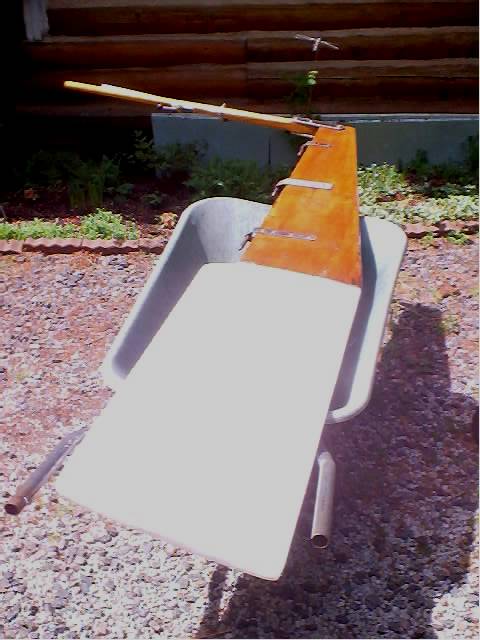

Your in great company Mitch. I'm convinced that every rudder O'Day has ever made will eventually deep six. You have priced the replacement, and announced your abilities, so start thinking in terms of building your own wooden one. Many of us have and would be happy to help you get started. Robert Krosse of Orillia, Ontario is starting his attempt at a rudder as we speak. It's not that difficult and should take no more than a week to fashion. Add a third (middle pintle) while your at it and you will never have to deal with this annoyance again. Don

That's beautiful! I may be going this route. First I will investigate a J24 rudder... take care, Mitch.

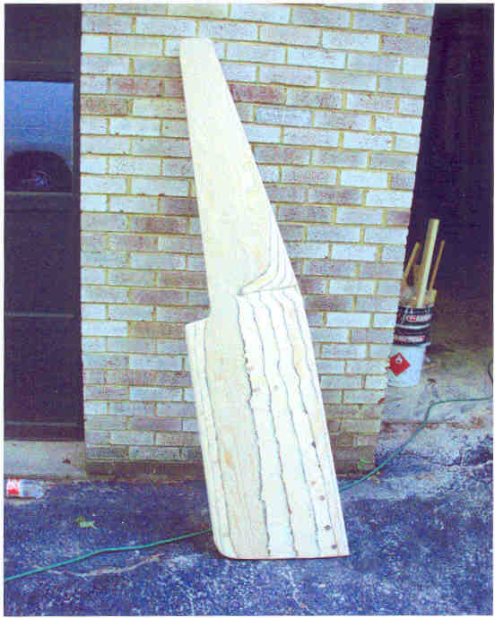

Well, I have heard so much about broken 25 rudders, I decided to start mine about 2 months ago. I am in no hurry, because mine is not broken. I went with a suggestion Don had a while ago. I epoxied two layers of marine plywood together. I had made a template from my rudder last fall. I laid the template on top, traced it and cut it out with a saber saw. I then trued it with a power planer. Last Friday I tapered and shaped it to a point of 90% complete. The tapering had to be done with a power planer then a sander. It is extremely difficult to hand plane because the plys of the plywood run in 90 degree directions. There was one advantage, the glue seam in the plywood shows how even your tapering is. When I was done planing the glue seams looked about 2.5 to 3" apart. From here, I still have some sanding to make the tapers on each side even. Then I will epoxy the entire rudder. Epoxy paint it and ablative bottom paint the submerged portion. If you don't have a power planer, I would go to the solid stock like Don did. r.w.landau

I took a picture this morning of the90% completed rudder. The cost of this was $60 for the 3/4" marine plywood, $59 for the west system. The paint will probably be $60. It took me 1.5 hours to pickup, cut, epoxy together. Then about 1 hour tracing the template cutting the shape with a sabre saw, and 2 hours shaping and sanding. It will probably take a total of two more hours to complete.( drying and curing time not included.) That is a total of about $180 and 6.5 hours work.

Got a question folks. But first...the pics are awesome, and it looks great. Now on to my question. I have an intact rudder, however the leading edges are pretty worn down. It was made of wood. I was wondering what ya'll thought about filling in and fairing/shaping with expoxy and a good coat of epoxy on the whole thing. Chuck
