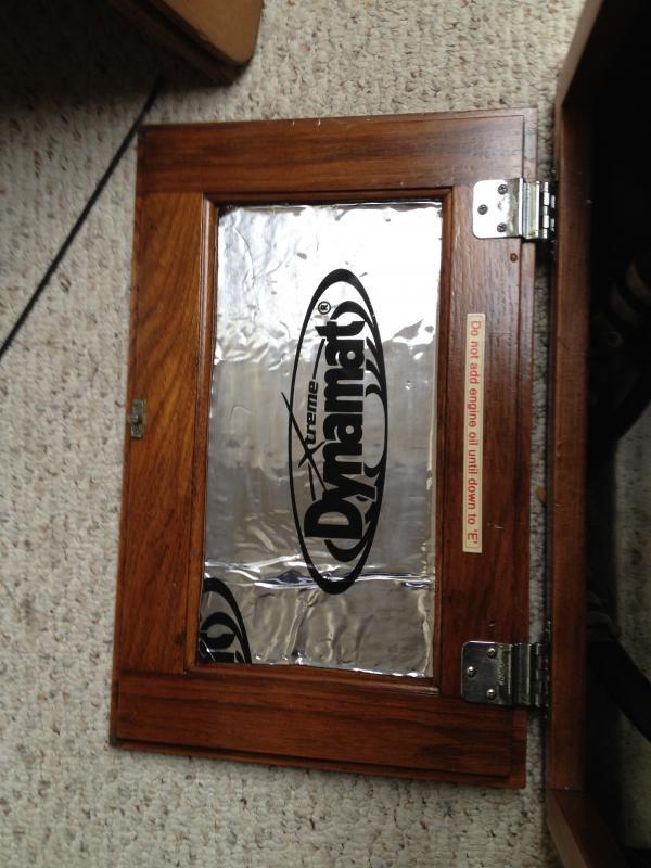

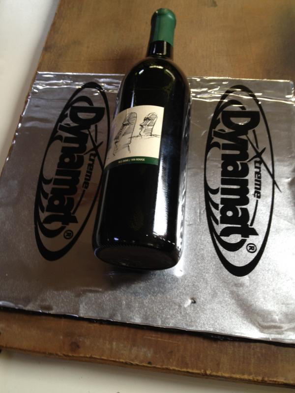

So, I paid the $, purchased 2 types of sound Insulation materials and finished the install today. I used Dynamat, which is primarily an Automotive product, but is nice and thin, and the 1/2 inch foam product from West Marine, both came in 12 sq. foot quantities which was perfect for the C 30.

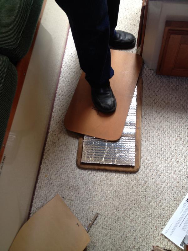

Notice the hi tech rollers, and the equally hi tech compression techniques used.
Fired up the engine after install, the results are;
most of the clatter from the valve train is gone
all of the high frequency noises have been supressed
low frequency noises, transmitted through the engine mounts, and hull are still there.
I left cut outs where the Insulation would have been too close to the exhaust, and to the fuel injector rack.
Total cost with taxes, about $250.
