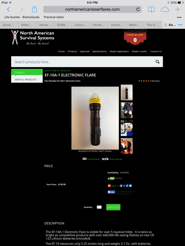

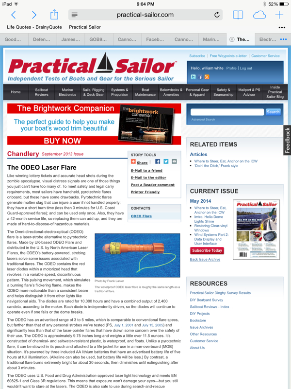

Along with a distress flag it's finally a legal alternative to flares. Flares are a fire hazard so I thought this may be better. Having said that I've safely carried a flare gun and flares since they were first mandated (in the early 80s if my memory serves me correctly.) Once again, where can we get them? I would think any marine supply center would have them, but not so. Phil: are you listening?
Alright.
Oct 24, 2010
2,405
Hunter 30 Everett, WA
Alright.
Thanks Emergpa1
I think it it was USCG compliant I'd buy one. Too bad.
I still think someone should produce something compliant.
It looks like this one fails in SOS timing and the overhead direction (since it's made up of rotating laser diodes.)
Ken
