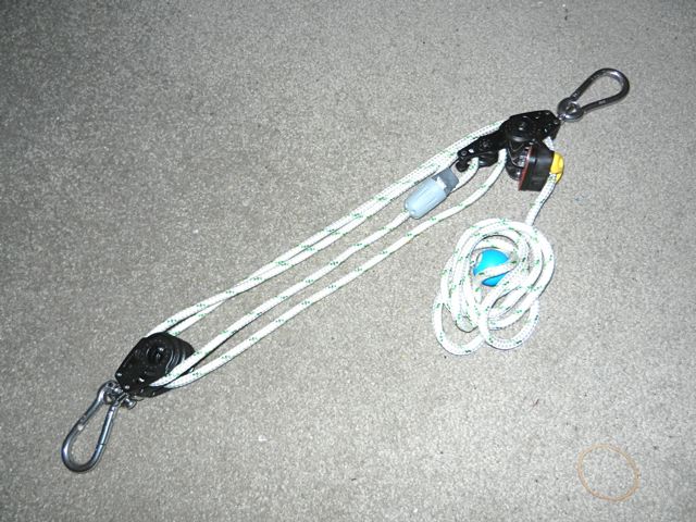

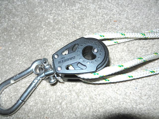

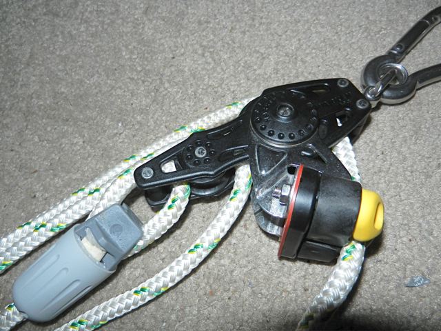

Re the double block, it was just that I found that and the fiddle w/camcleat from the same seller on ebay cheap. A fiddle would do as well (maybe even better as the line would run straighter).Yes, I was planning on using the 40mm blocks for the vang. I thought 6mm was the max size line for those blocks though. Thanks for the batten measurements. I was planning on using a fiddle block for the upper block...looks like you used a double block. Any difference between the two? And please tell me about the plastic device that is in lieu of an eye splice or bowline know on the becket...I have been away from sailing for a few years and haven't seen that.
Re the 'plastic device', they're called Splicingnuts. I started using one on my main halyard to stop the bowline from becoming jammed at the top of the mast (a PITA when you want to drop your main fast and it won't come down). Here is the link for the manufacturer but I expect you can get them from online chandlers also:
http://www.splicingnut.com/?page=product_info
I use them on my main sheet block, Vang, and a block setup that I use to easily attach the fore stay (I raise and lower my mast every time I sail). You buy them as per your line diameter.
Re the 'stopper thingos', I use them everywhere. I have also colour coded most of my lines, sheets and even camcleat fairleads as I regularly sail with 'non-sailors'. I found it was much easier and more effective to yell "pull the red rope" than "tighten the port jib sheet"
Also, if you haven't worked it out by now, yes I'm a gaget freak.
