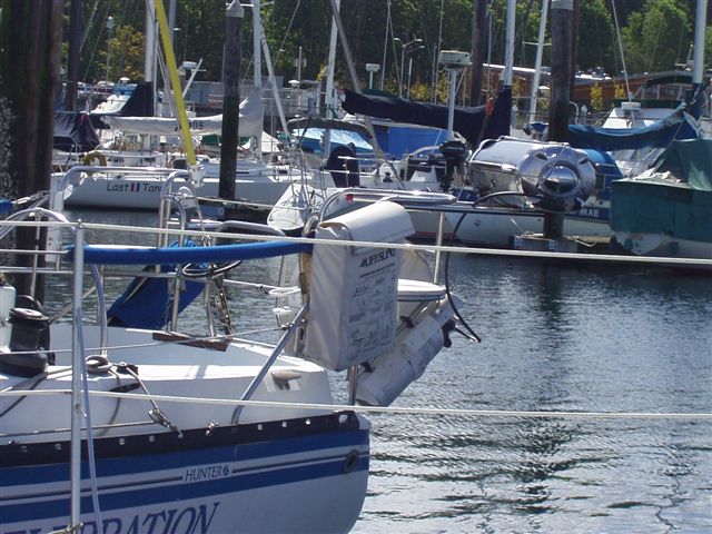

Propane locker
Putting in the bulkheads isn't too bad, I made cardboard templates and 1/4 ply with a fiberglass skin pre-installed on the locker side and used thickened epoxy to fillet the edges. It took a weekend to do the first one and one Saturday to do the second. I closed off the area from the Lazerette hatch to the forward end of the Lazerette Sole. This leaves plenty of room for the plumbing and solenoid and a 1 gal gas can for the dingy.

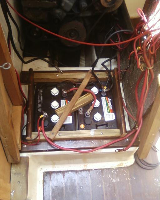

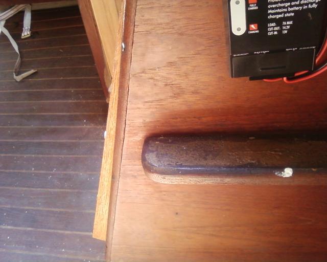

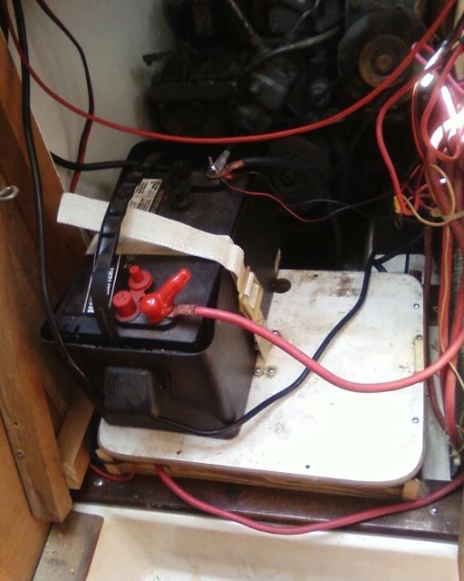

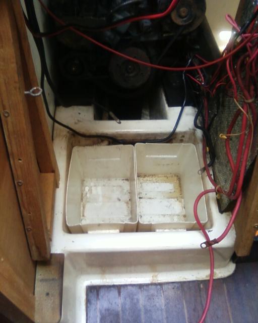

Just installed two 6 volt batteries in the shower sump. Thought you might be interested. Attached are a series of pictures of the installation. 1st, Battery boxes fitted into the sump. 2ed, holding framework to secure the batteries and provide a base for another battery platform. 3rd, starter battery secured on the original sump/battery base. 4th, added a 1" extension to the engine housing to allow for group 27 batteries to be stored. In the future the battery bank may be expanded to four 6 volt batteries. They are not needed at this time.

Question for Paul F.
Paul I have an 81 H-33 with two CG-4 6 volts in the shower sump and a group 24 start battery above. I am a little puzzled about photo 4 and the Group 27 storage, could you elaborate? ( I'm always looking for ideas to steal :) )
Paul F
Jun 3, 2004
827
Hunter 1980 - 33 Bradenton
Engine compartment push out
The reason for adding the extra length in the engine compartment was to allow room for two group 27 batteries atop the shower sump in the "normal, original" battery location. by pushing out the forward panel enough space was gained to place the batteries over the shower sump. Then a smaller group 24 starting battery was placed over the two group 27's. When the group 27's gave out they were replaced with two GC 6 volt batteries which are located inside the shower sump lower in the boat with the same starting battery above them. The extended room in the engine compartment is not required now. The change was described in the thread to show another way to modify the location for storage.
