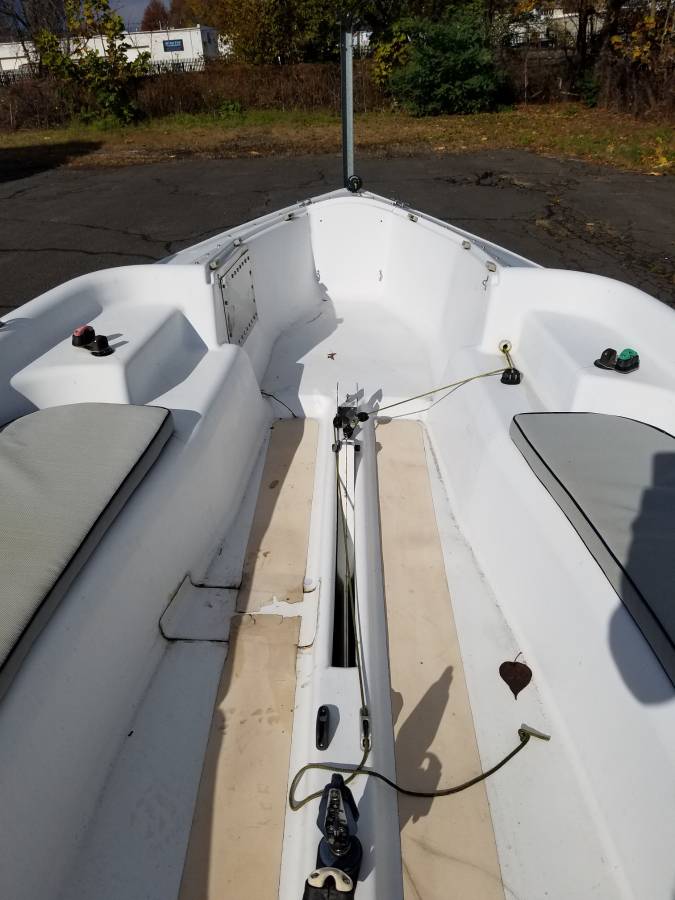

This 170 just came up on craigslist Central NJ for $1950.
Someone did not have the factory repair manual and came up with their own. I am guessing the owner is an HVAC guy.

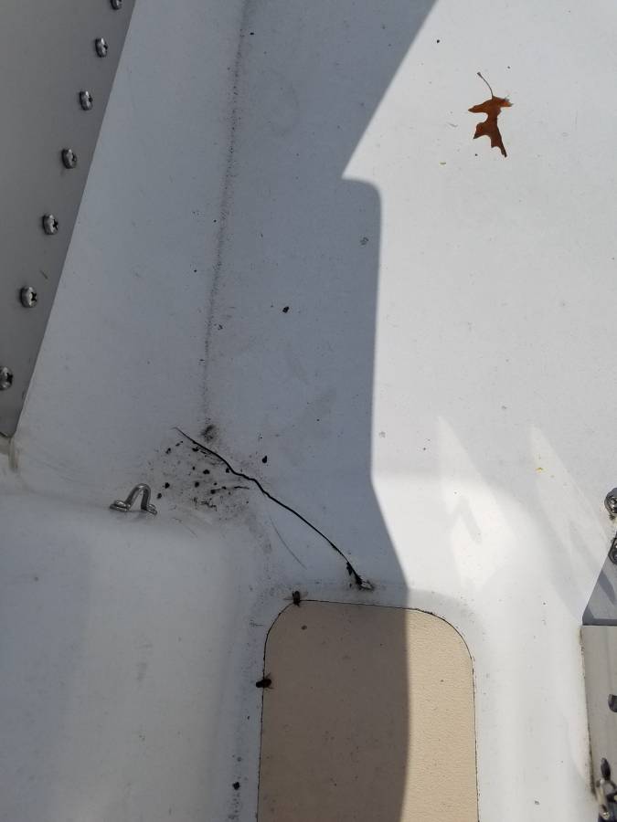

Are your repairs "factory approved"?
Yes, I am following the factory repair procedures for the cracks.
Well on the 2 long cracks I did not sand the area thinner and put a layer of epoxy and glass on top. My thoughts are to try just using epoxy in the crack (much less work) and if that does not work I can always grind out the epoxy and do it over with the glass.
For the loose plastic to foam there were no factory guidelines per se.

I know you are messing with me, but oddly I am following factory procedures.

I am quick to point out I am no expert. I am a scientist at heart so experimenting and understanding the properties of stuff is in my blood. I have been known to go down roads that others have not and sometimes gotten rewarded and sometimes failed.
I read the tech sheets and try stuff. I do have some experiences in other areas that seem to cross over to the boats.
In the end the proof is in the repair down the line. Did the fix stay fixed?
I may find 3 years from now that I screwed up big time.
