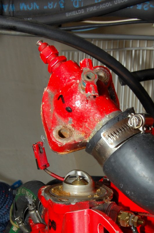

While I was working on my engine I made a few tweaks that will make things a little simpler and cleaner.
I replaced three pet cocks like this:
With 1/4 turn ball valves like this:

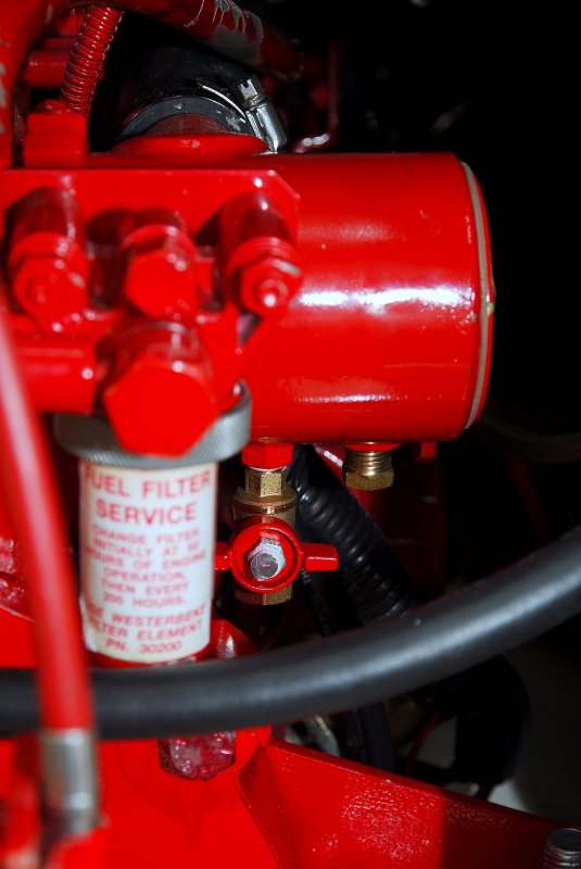

This valve will make purging air from the fresh water/antifreeze side of the engine MUCH easier and I won't burn my hand or get antifreeze all over my engine anymore in doing so. I added a hose barb and hose so I can stick it in a bottle and carefully crack the valve to remove air. Sure beats those pesky pet cocks..
I also replaced the pet cock on the HX to make draining it for zinc changes clean and easy with NO MORE salt water on my engine! I will be adding a hose and barb to it also.

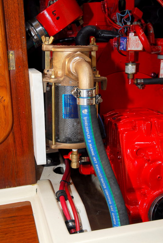

One more 1/4 turn valve on the sea strainer prevents back siphoning from the height of the siphon break loop when you open the top of the strainer. Again I will be able to clean my strainer without salt water oozing out the top and into my engine compartment because I will drain it first..

Nice modifications, where did you find those neat petcocks? I have a Westerbeke and I know what you mean about getting sea water or antifreeze all over the engine
also did the petcocks come with red handles or is that your touch
Feb 6, 1998
11,722
Those are actually 1/8" by 1/8" male/female 600 PSI WOG or 150 PSI WSP (working steam pressure) forged ball valves. They are often used for air vents on hydronic & steam heating systems so they could easily be changed by closing the valve then unscrewing the air vent and replacing it. The red handles are the way they came from my plumbing wholesaler.
