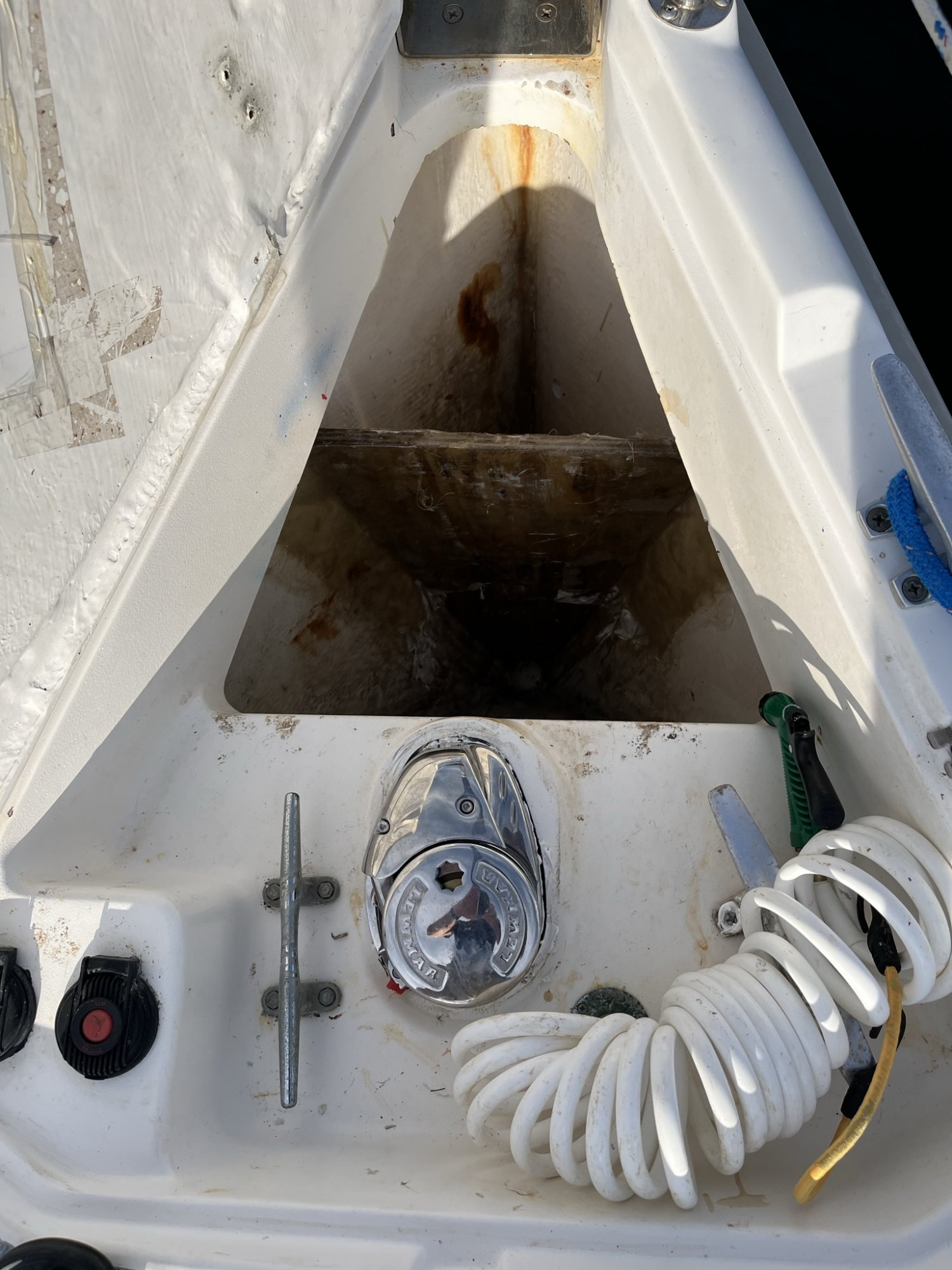

Made a separation partition in the anchor locker. Fiberglassed it in.Attached is a pic.
Also replaced the old windless with a Lewmar V3. The bolt holes lined up but had to make the chain hole a little bigger.
