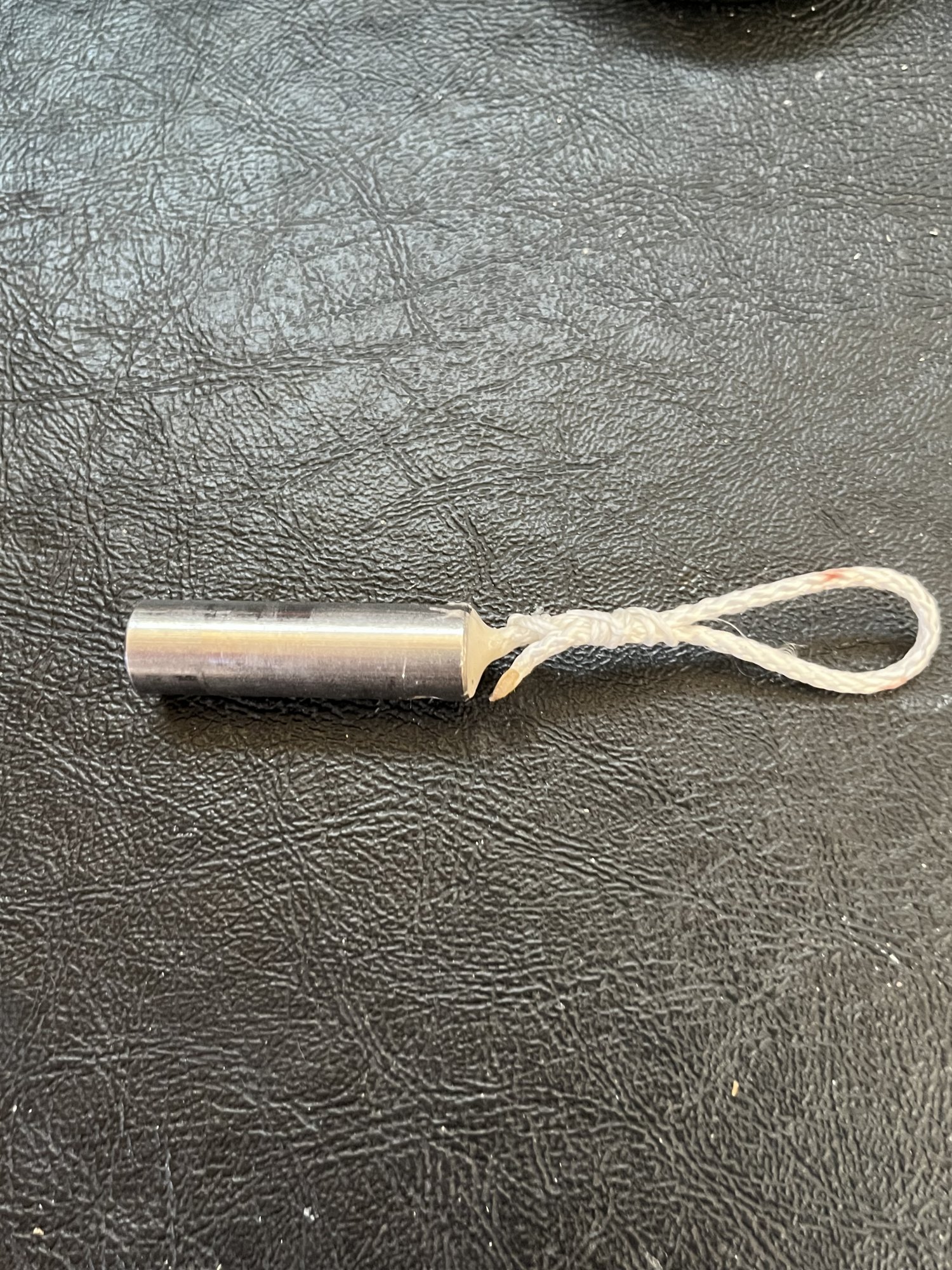

Here’s the solution…
Take the pin, put it in a vice on a drill press, and drill a 9/32 hole down the end. You can’t go very deep, because the cotter pin hole is about 3/8” down cross-drilled. Just go as far as you can until you are just slightly breaking through the cotter hole.
Then, re-drill the cotter hole (same size) to clean out the burr.
mix up some JB-weld.
man’s then install a short “handle” into the end of the pin
in addition to being a safety loop you will tie whipping twine to, (so that you don’t lose it in the mast) now you have something that you can rotate the pin with to line up the cotter pin hole.
This trick really works well.
the hole isn’t deep enough to get a thread into, which is why I opted for the JB weld route
