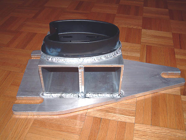

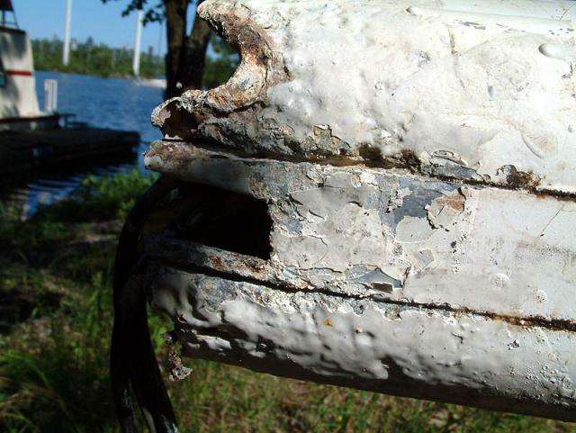

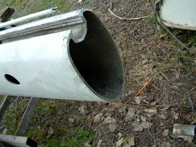

The mast base and the the lower section of the mast on my H37 was very corroded, so last week I decided it was time to do something about it. After a close inspection, I figured out that I had to remove at least 4 inches down the bottom to get to sain material (as seen in the first pic). In order to remove 4 inches and still keep the mast at the same height, I designed a new mast base using 4''x4''x1/4'' to raise the foot. Plus, the old mast base plate was very corroded, I decided to go with a 1/2'' base plate instead of the original 3/8'' thick one. To avoid furter corrosion, I painted the new mast step with two coat of an epoxy paint, as with the rest of the mast. Hope this may help someone with the same problem.
