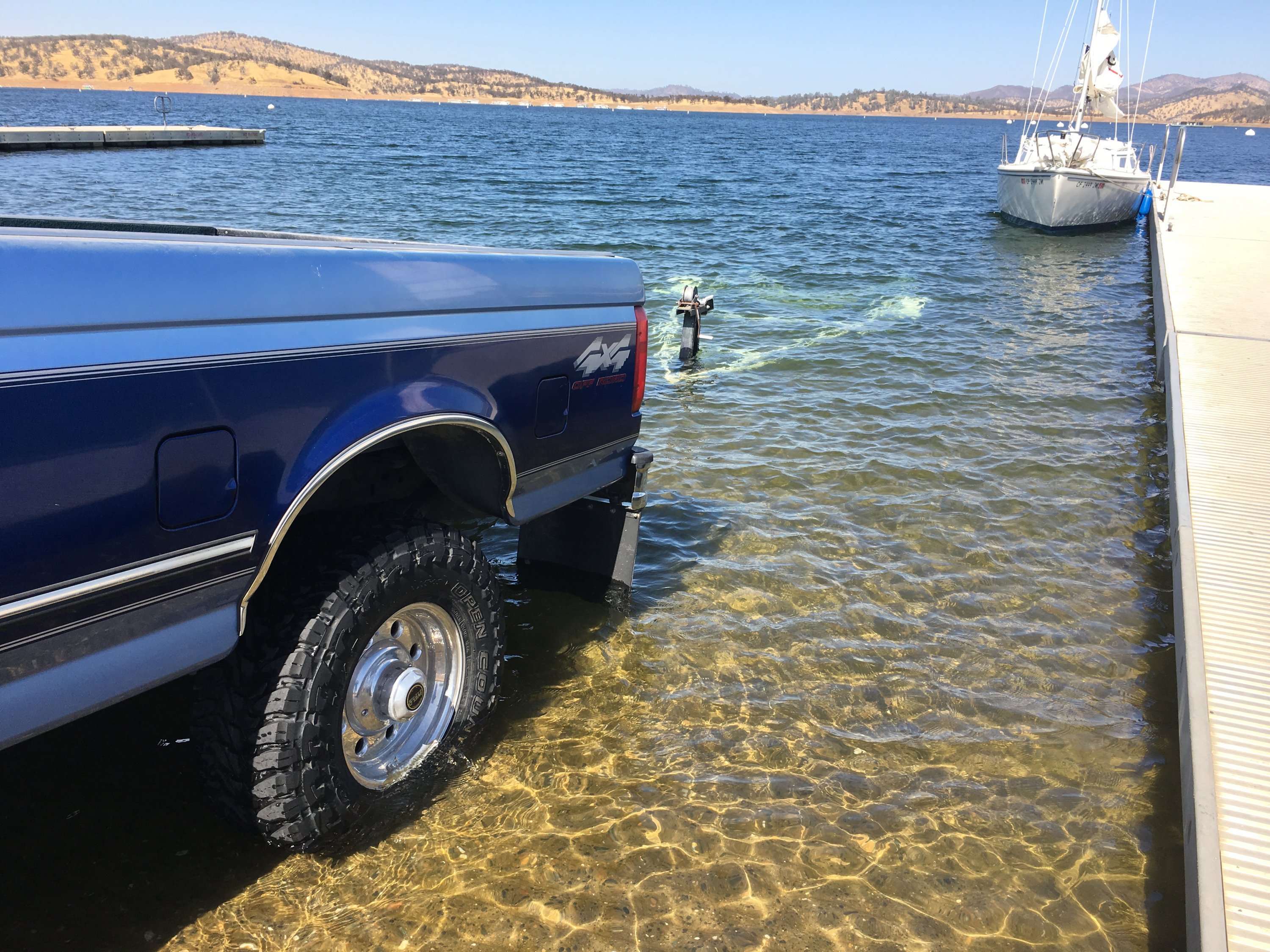

That's about as close as I ever got to half drowning my car... Jeep Grand Cherokee 2.7 CRD! We were on a 4x4 Safari in the Perdeberg region in South Africa. The Jeep was to this day still the best "car" I ever had.
The view from the top was well worth the effort to get there!
I have no intention of trying this while launching a boat! :laugh:
