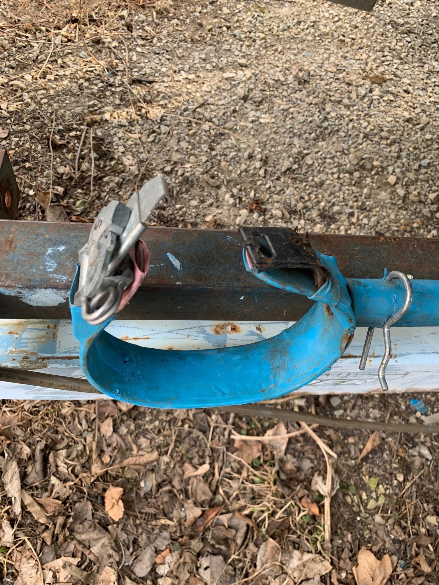

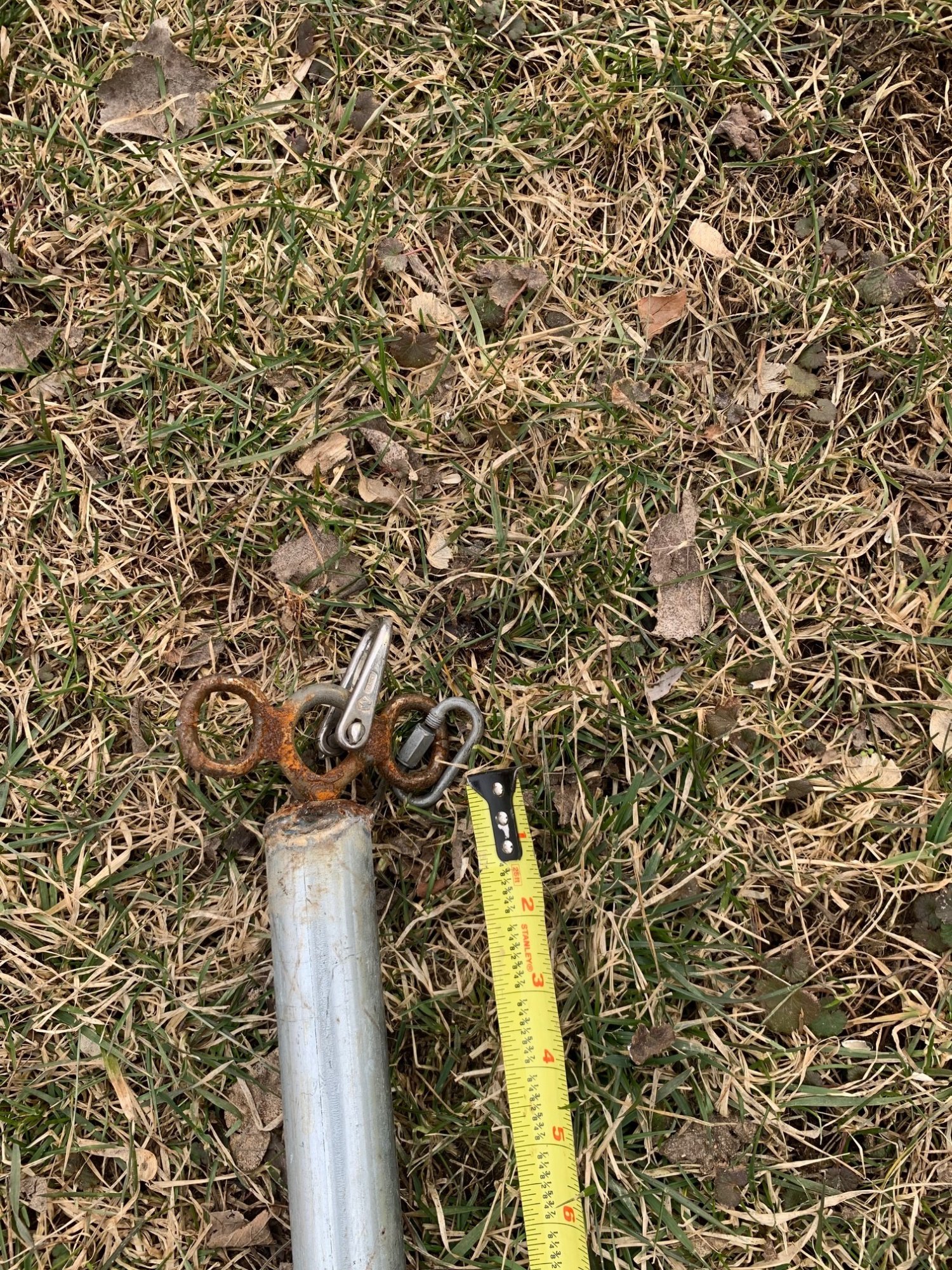

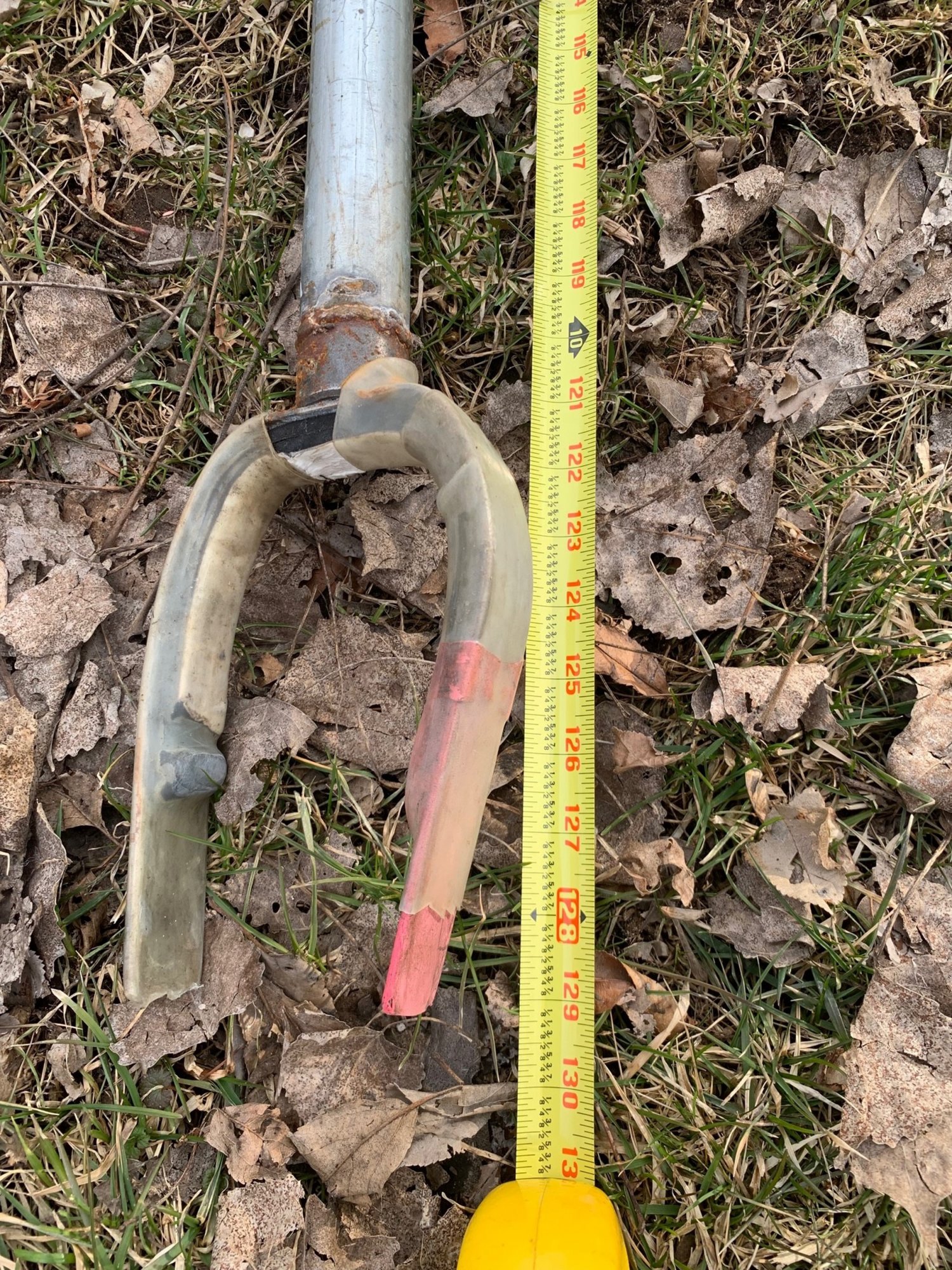

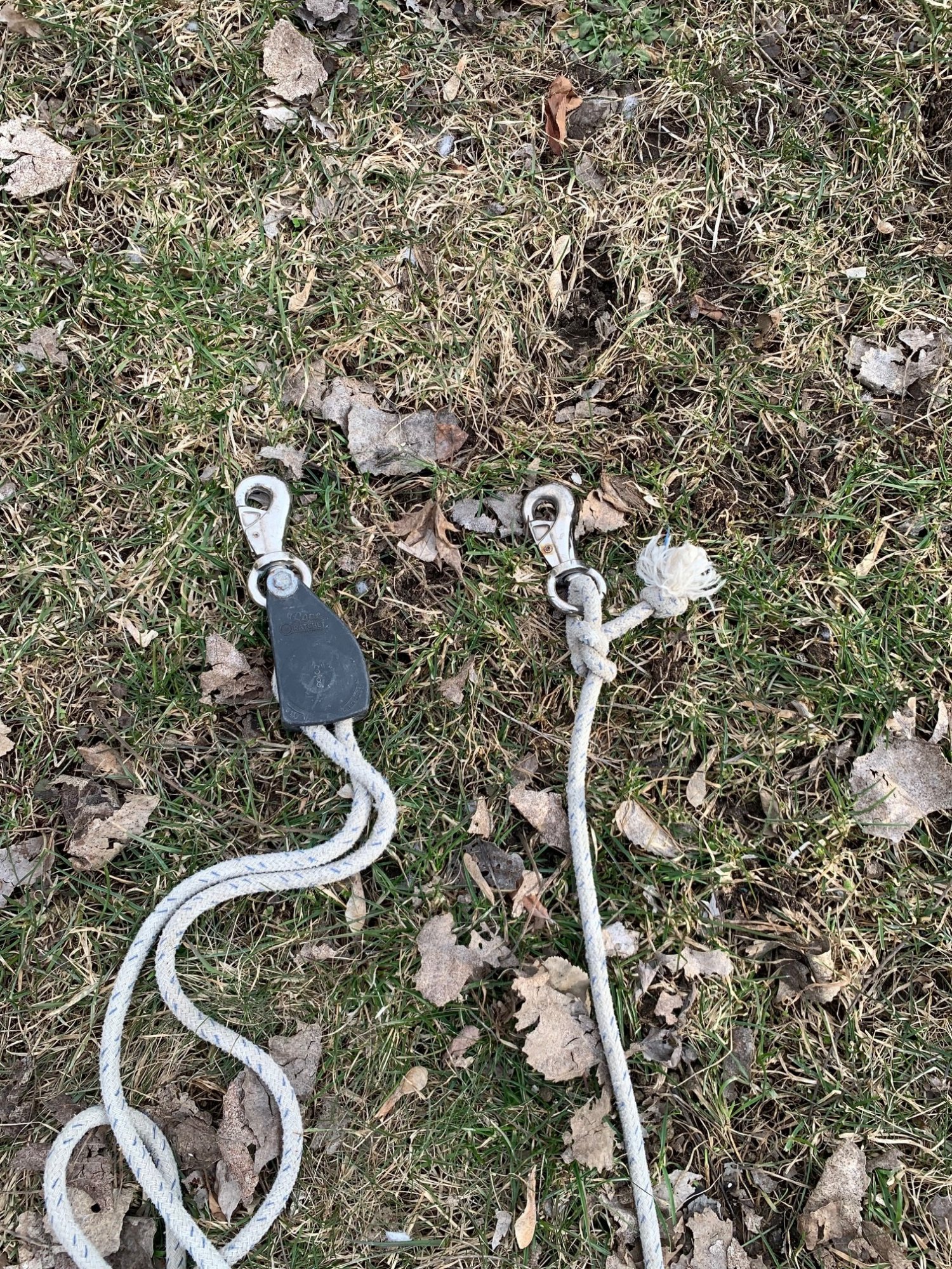

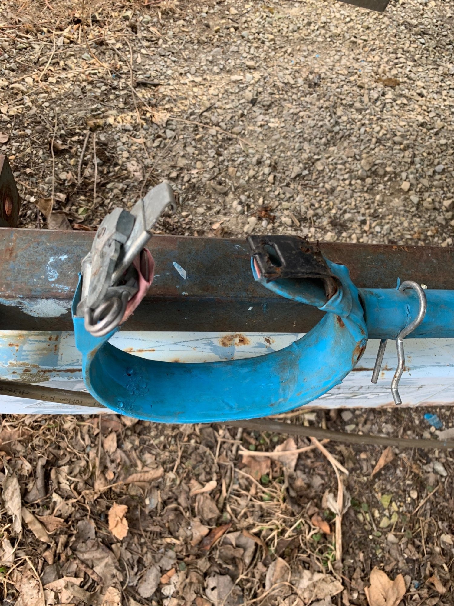

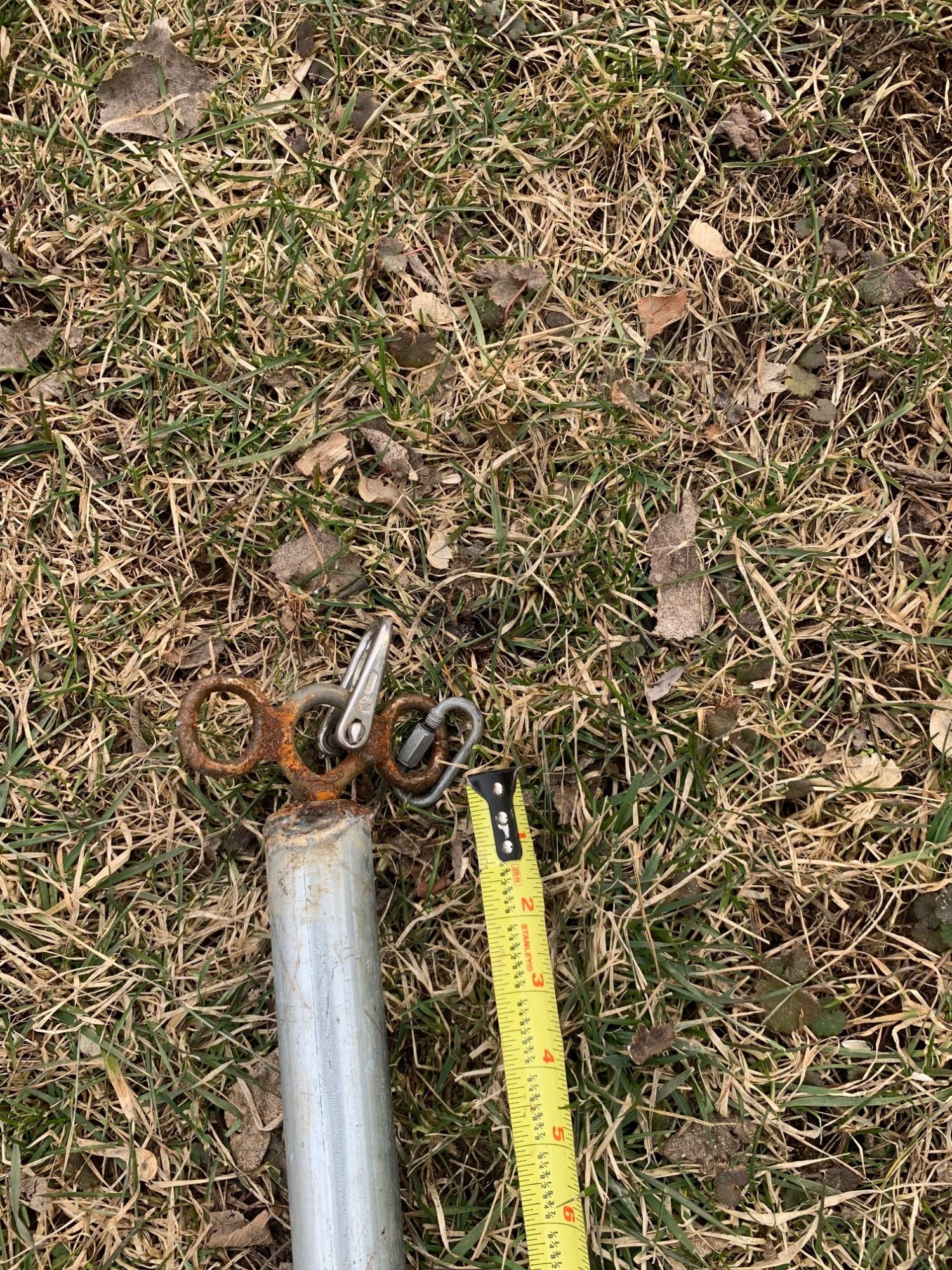

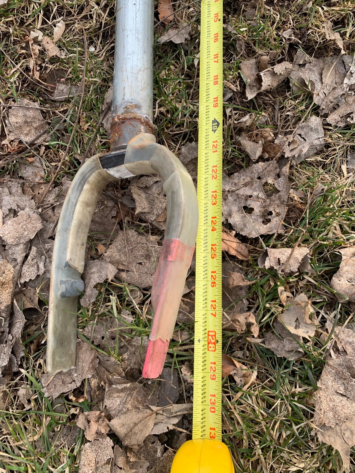

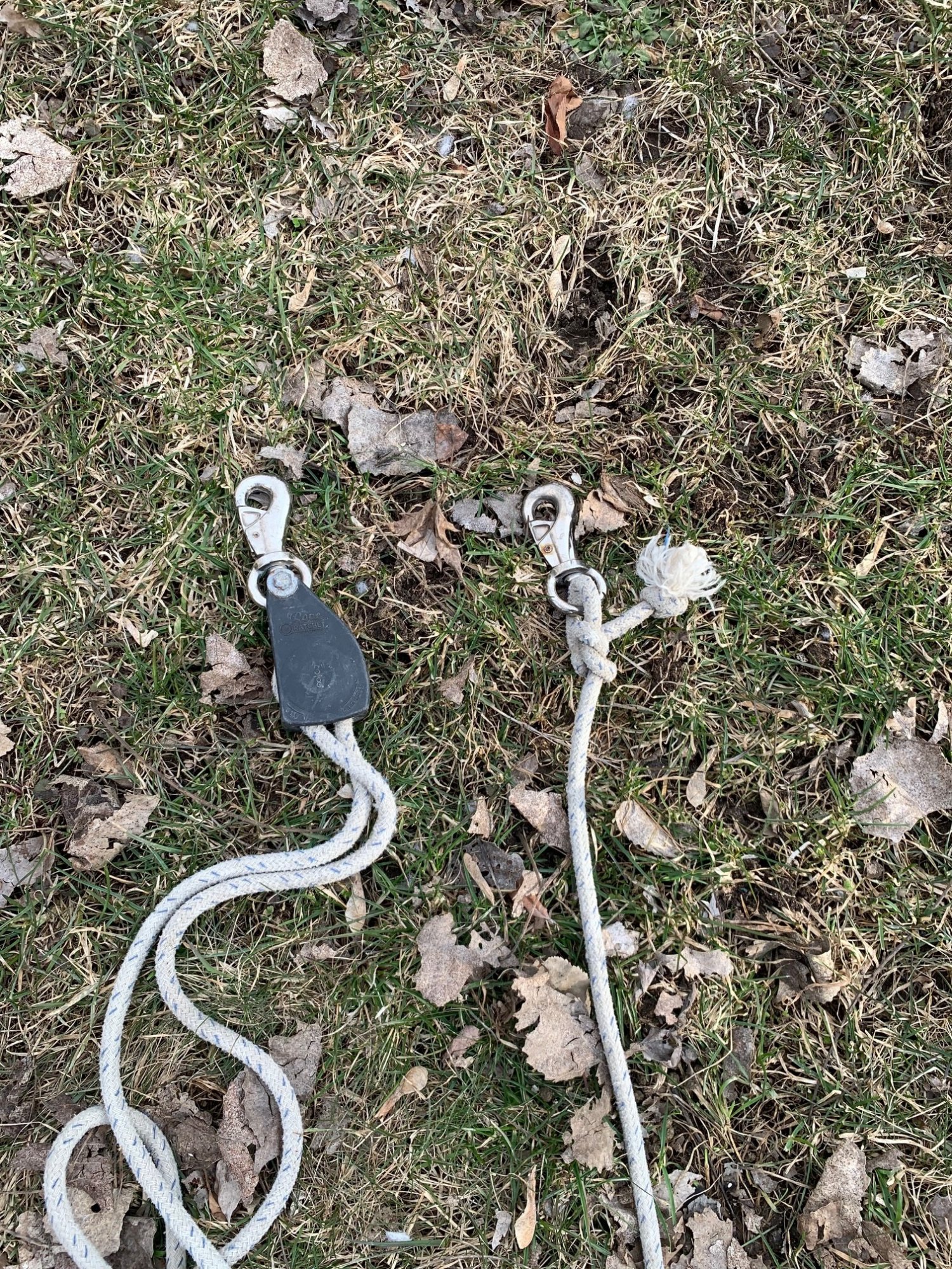

The first two pictures are of the gin pole I tried last fall . It's the third variation . The second version had a clamp that tightened around the base of the mast . Simple and almost impossible for the gin pole to seperate from the mast base . The rope ratchets in the last photo attach to the triangular plates on the upper side stays . The snap shckles make it very unlikely to come off during the stepping process . One might also attach them to the stanchion base . They need to be adjustable as the pivot point on the bottom of the mast is differant unless you have the triangular plates .
I am currently using a double block on the end of the gin pole and the other on the bow stem fitting.This line leads back to the mast mounted winch
With this set up ,I can easily singlehandlingly step the mast with the boat either on the trailer or even on the water . I can also stop at any step of the process safely to catch an errant stay . I hope this helps
