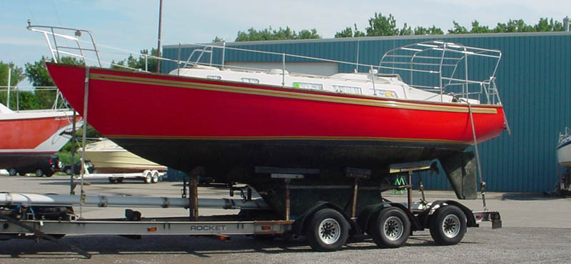

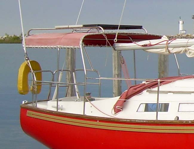

I have a solid Bimini on my boat. The previous owners had it fabricated. Three 40 watt solar panels are mounted on top and there is room for more or bigger panels if I wanted. The solid Bimini has its tradeoffs but, overall, I like it.
You can see the bare frame in the top photo. The bottom photo shows what it looks like with top canvas and solar panels.
