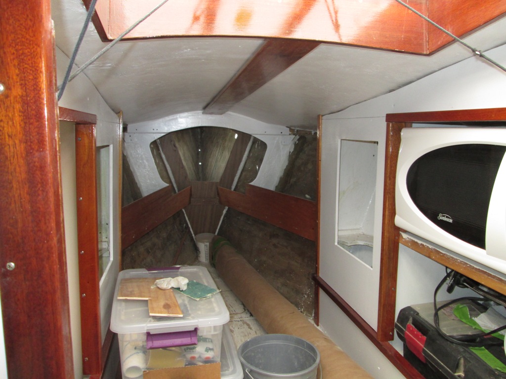

...and some, psychos like me, have converted their sloops to cutters - because they know the value of that inner jib, the BEST SAIL ON THE BOAT.
Hardest bit to doing this is providing adequate support for the inner-forestay chainplate. I built a whole abbreviated bulkhead across the foot of the v-berth. Use of 'glass and good plywood here is a must.
Second-hardest bit is figuring out where to put it! - but I had a secret system for that. :cool:
