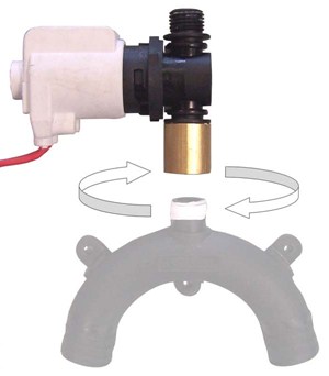

I'm guessing you're referring to the solenoid valve in the flush water intake line for a electric macerating toilet. If the toilet is a sea water toilet, the solenoid is actually an electric "air valve" in a vented loop, so it'll be (at least it SHOULD be) in the toilet intake line high enough to be at least 6-8" above waterline at any angle of heel...which on most sailboats puts at least 2 feet above the bowl . If it's a toilet designed to use onboard pressurized fresh water, there won't be a vented loop, it'll just be a valve in the the intake line between the back of the toilet bowl and the cold water line to the head sink...which might put it under the vanity or in a locker near the sink. I'd be very surprised if it's in the engine room, but anything is possible.
However, depending on the make/model of your toilet and whether a solenoid valve is needed, there may not be one. What's the make/model of your toilet and why are you trying to find it?

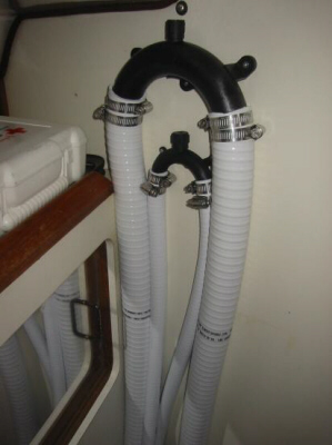

That sounds like the loop is installed too low in the boat. Vented loops need to be at least 6-8" above waterline AT MAX HEEL, not just when the boat is at rest. On most sailboats, that puts it 2-3 FEET above the bowl...it's typically mounted on the bulkhead directly above the toilet. See photo. (It shows both discharge and intake loops...you may or may not need both).
If the toilet is a Jabsco 37010, there's a much better place to put the loop that doesn't require a solenoid valve: That toilet ( btw, Mike, same is true of the sea water version of the SeaEra) has a connecting line that runs from the base assembly to the back of the bowl. Replace it with lines long enough to put a vented loop at the the right height above the toilet. No solenoid valve is needed because they're only needed in a line through which water is being PULLED.. Flush water is pulled TO the pump, the pump PUSHES water to the back of the bowl.
