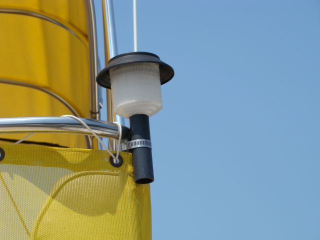

There are easy cheaper ways I am sure to fasten to stantions but I had a coupon for WM and the clamps I think were $20 for 2 and some PVC and stainless screws and they can be removed with a screw driver and look good.
I have them high on my bimini and any of my railing and stantions too.

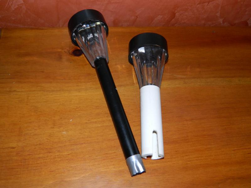

Walmart lights. 3" of electrical tape around the base and they fit the winch handle socket like they were made to go there. Slice a 4" length of PVC; it slides over a 1" tube stanchion tube with a little coaxing. A spot of epoxy to the base of the light (to keep it in the PVC) and you have a light that snaps on quite nicely and cost $4. The winch ones you have to put someplace in the sunshine to charge. You can always use a throw-away AA cell. Another light that I won't sail without is a 3-LED puck light, you know, the one you stick in a closet and push of 1-2-3 LEDs? Lots of uses, even makes a great mast light if yours fails. Ask me how I know.

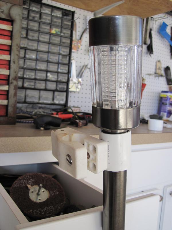

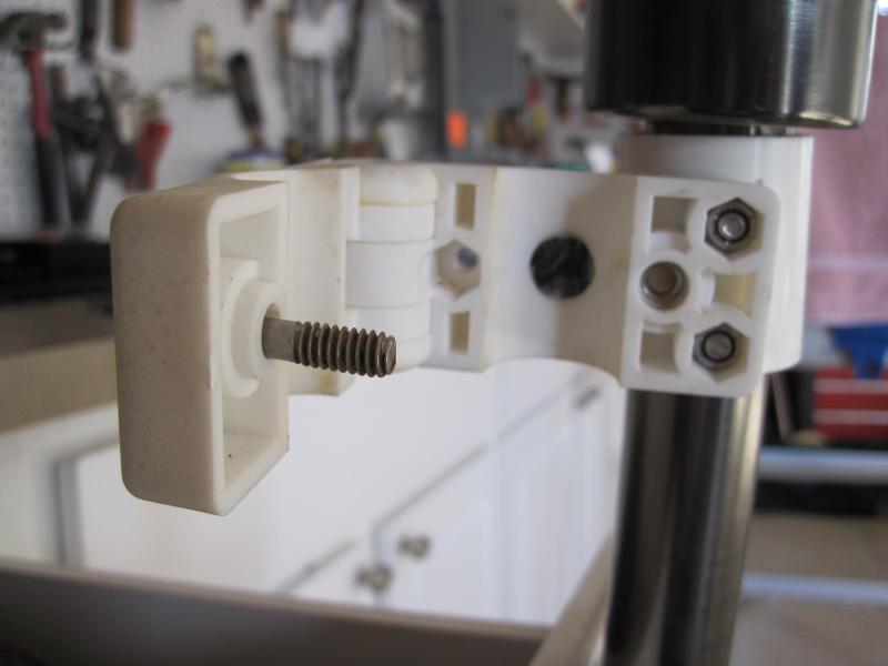

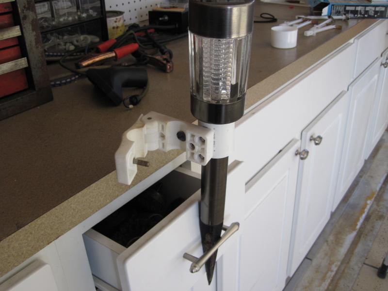

Here is a walmart light and west marine clamp and pvc pipe connector and will shorten the light holder and clamp to stantions.
I can show you in person bill & Mary
