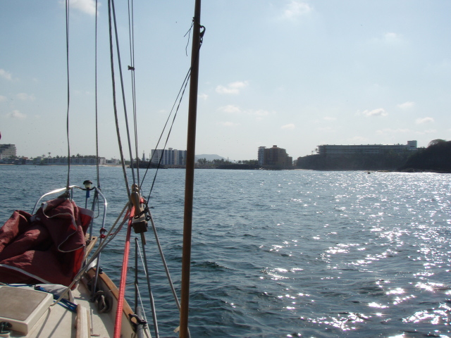

Use care when selecting a standard garden light. We bought a set of 4 in La Paz mexico. They were more than I wanted to pay, but sure did turn out to be the BEST in the long run!
We used them a LOT in the Sea of Cortez. Try to get ones that have a warm color. NOT the bright white ones! It helps if they look like a flame. Stands out better.
The cheep ones (like for US $5.00 will NOT last all night. The ones we got lasted for the full night and then some.
What we did was to just use a bit of the blue painters tape to secure one on the bow pulpit (see photo below) and used a bit of safety wire to secure on aft. They worked for years with no problems! I did replace one of the rechargeable batteries on one (the bow) with a larger capacity.

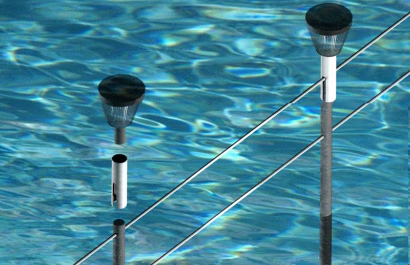

I also use them. A little rigging tape around the end and they plug into a winch quite nicely. If you take length of 3/4" PVC, drill a 3/8" hole and cut a slot to get around your lifelines, they plug on pretty well. The problem is charging. You can leave them in place as long as none of your lines will knock them off but I keep them on the stern until we anchor.

We have JUST now taken down the first of a pair of HD solar lamps, the replacement just now going on the stern rail. We used, as mentioned by another, a 3/4" pipe as our stanchion for it.
Other cheapies we put in the winch handle holes; they fit perfectly there by reversing the pointy plastic thingy, leaving a round thingy which is sufficient to hold it upright.
