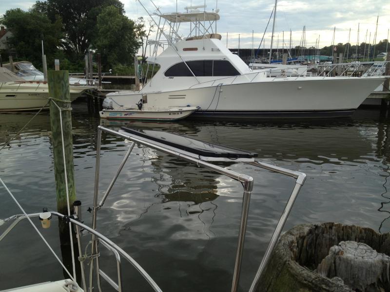

My metal fabricator got busy with other things so I ended up going on line to Defender and ordered all the parts I needed to create the framework to mount a solar panel on to. The current solar panel in the picture is my old one. 15watt. Its fine to top off the batteries during the midweek while I am not on the boat. My original intention was to upgrade to a 80 watt. Now I am rethinking it and have found a 100w panel with a controller, 40 ft of wire and connectors for $170. This will be much larger, therefor the size of the new frame.
The frame is made of 1" stainless tubing. It is adjustable so I can change out to the new solar panel easily when I purchase it. The only waste is two 12 inch pieces of tubing which I could use as cross peices should I need to make it more rigid.
If anyone is interested, here is the supply list:
2 pcs 6ft x 1" stainless tubing (thick wall)
3 pcs 4ft x 1' stainless tubing (thick wall)
4 - 90 degree rail elbows
4 - Top caps with eyes
4 - Hinged Top Slide Mount with Eye
2 - Top Slide Mount with Eye
4 - Hayn Pulpit / Anchor Sleeve Fitting
2 self manufactured spacers 2.5" in length x 1" wide x 1/4" thick
Stainless nuts, bolts and washers.
I cut one of the 4ft pieces into two and shortened the two 6ft down to 5ft to match them to the uprights of the stern rail. I attached the couplings and the 2 uprights first. Then slid the slide mounts over. To the two side mounts I attached the 2ft pieces and capped it with the remaining 5ft piece. The solar panel is attached using the Pulpit sleeve fittings
See pictures:

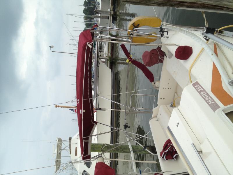

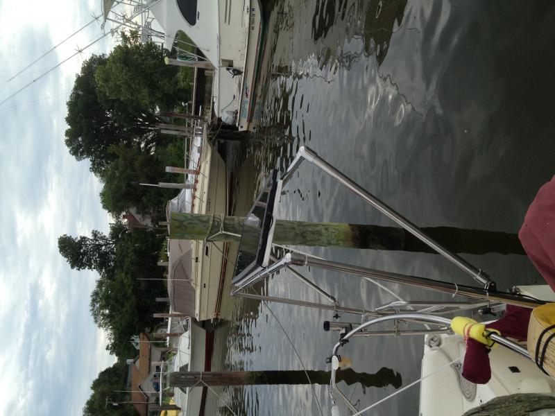

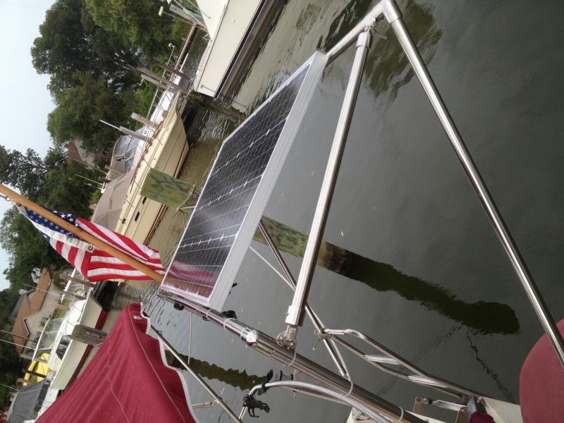

As an update to my solar project I have the following to report. I purchased and installed a 100w panel, using my previously installed controllers. I ended up having to purchase two more 48" stainless tubes from Defender. Here is the final result in picture form. My Batteries are recharged in no time flat, so I can use all my electronics and see very little battery usage. Sorry if the pictures are sideways. Haven't quite got the hang of getting them the right way up!
