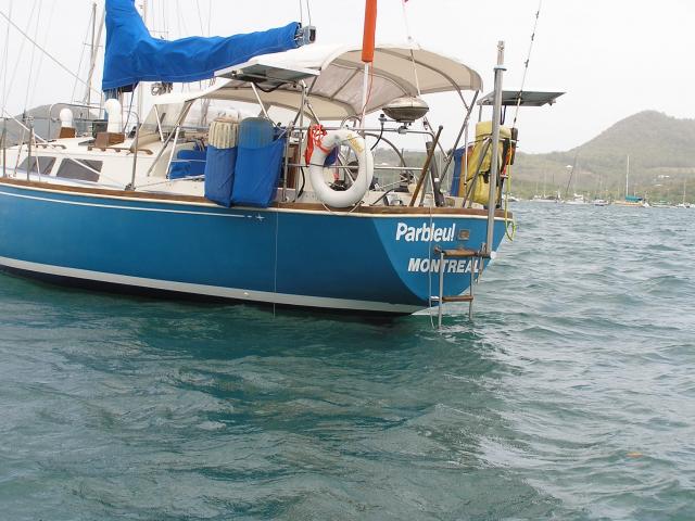

I used to have two 35W panels on swivel mounts on either side of the cockpit... we forgot to bring them in a couple of times when docking or transiting a lock; they don't look so nice after that.

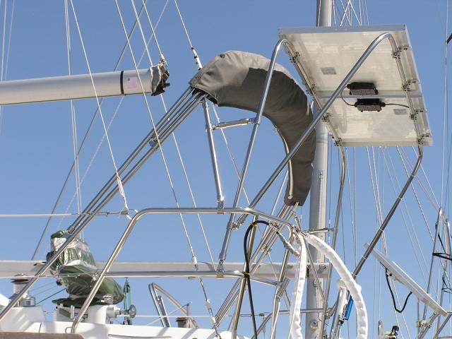

On our new boat, the stern is much wider so I managed to mount two 85W panels behind the bimini. I dislike arches and davits so I managed to install the panels with only two 1 inch stainless tubes. The Bimini folds out of the way and the solar panels don't go further back than the swim platform.

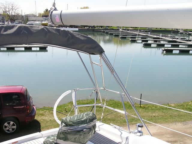

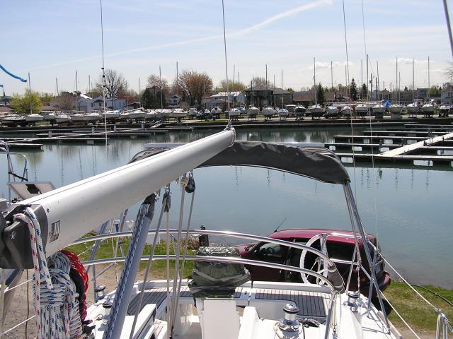

I went to the boat yesterday, took a few pics & then put on a coat of antifouling. Since it is snowing to-day I have the time to put this on the forum.
I had the tubing bent & installed by a local canvas & awning shop, I installed the panels & wiring myself. These are two 85W panels & should be more than enough for all my needs; the boat is on a mooring & I would appreciate using the fridge all summer.
You can see the swivel panels on my old boat: these were 35W each & weren't enough for the boat to be completely autonomous, but they helped. On the Atlantic crossings (3) they kept the engine running time to just under an hour a day, usually before the HAM net. However we forgot to take them in when docking & hit immovable objects & dockhands more than once.

nice! I went to the boat the other day too and found that panels tilting out from the side rails might easily be swiped off by a bad docking from my neighbor or myself.. not sure I want to go that way. the bimini seems a great place to go but I like to fold them up from time to time... I like the location all the way in the back like that. I found the price for the panels werent as good as I though and its dropped down a bit on my list but still on :) thanks for pics!
