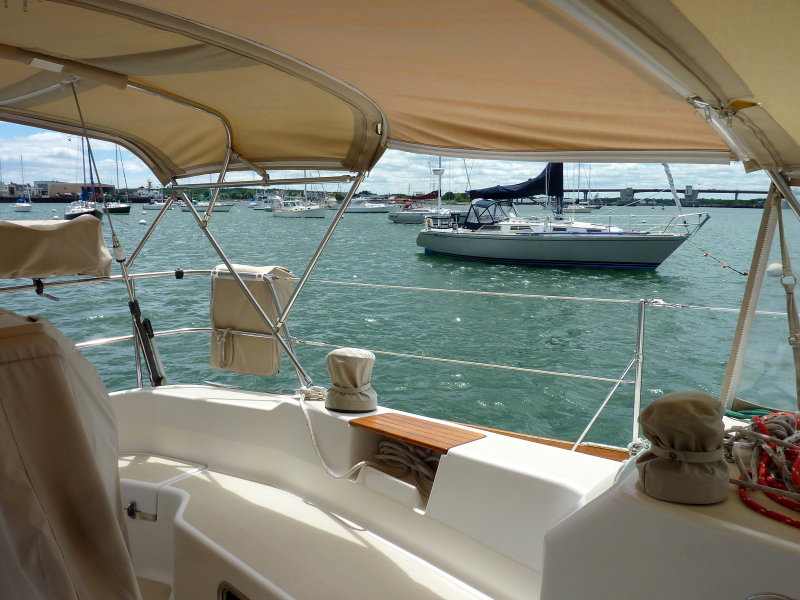

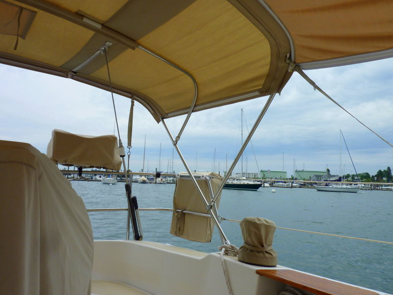

Our C310 came from the factory with the struts to the stern rail. Our neighbors on a C320 liked them so much, they put them on their bimini.
