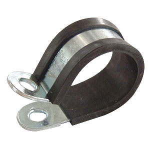

I have a new bimini and really don't want to put any holes in it. Is there any problem with attaching anything to the backstay? I was thinking about using clamps (see attached pic).

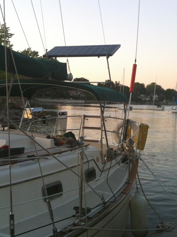

I tried that earlier this spring with a 140W panel thinking that there are backstay mounts for radars so a panel should be ok as well.
My boat has dual backstays and it seemed to be a perfect place to mount the panel and actually, it looked great once I go it up there. (see pic).
With the dual backstays, keeping the panel from twisting was not an issue. Where I ran into a problem was the amount of fore and aft movement of the panel and the backstays. In rough conditions the panel woudl have bounced back and forth 8 - 10 " and woudl eventually have struck my bimini not to mention the stresses imposed on the backstays.
So I went to plan B which was two posts mounted to the stern rail and steadied by ratchet straps. This will do fine until we get davits for the dinghy.
If you would like me to take some pics this weekend, I will be happy to do so.

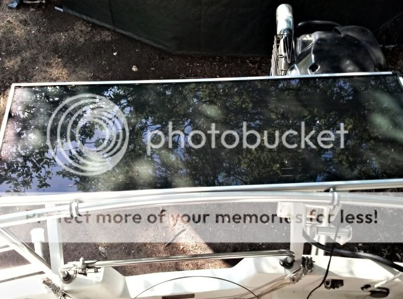

I used 1" isolators to attach it directly to the pulpit, and them some 1" square aluminum tube for supports attached to 1/2" isolators attached to the bottom of the traveler bar. It works great, is very sturdy, however my only issue is its kind of a pain in the butt to remove them when I need to put the mast crutch in the gudieons when raising and lowering the mast, so I'm trying to find something that makes disconnecting it simpler.

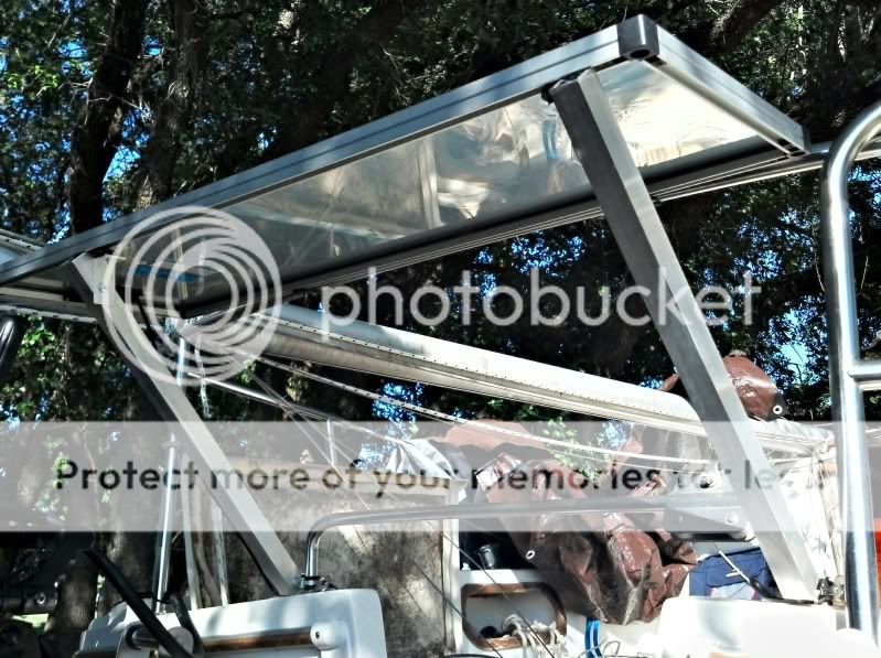

try doing sloar panel install on sailboats search for some good ideas,I will be installing panels on my H-36 and have no backstay but will be using 1'' stainless tubing as a permanent mounting off my Hunter arch to back of bimini which have seen on the web and they kind of are say fragil and don't want them moving around or shaking around,your panels your decision.

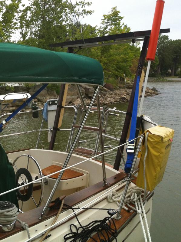

Here is a opic of my current set-up for my panel. Nothing high tech ..and it's temporary until we put davits on the boat next spring.
The panel sits on two struts (ok, ok. 2x3s) which are connected by a 1" aluminum tube at the top. There is a threaded rod running through the tube to pull things together. The struts are stabilized by ratchet straps. we went outsailing last weekend with this set-up and it is quite solid and stable.
Depending on the geometry on your boat, I am sure your proposed mounting method will work. The one thing I would think about is what happens to your struts as the backstay moves fore and aft (either waves or someone using it as a hand hold).
Hope this helps a bit.
Matt
