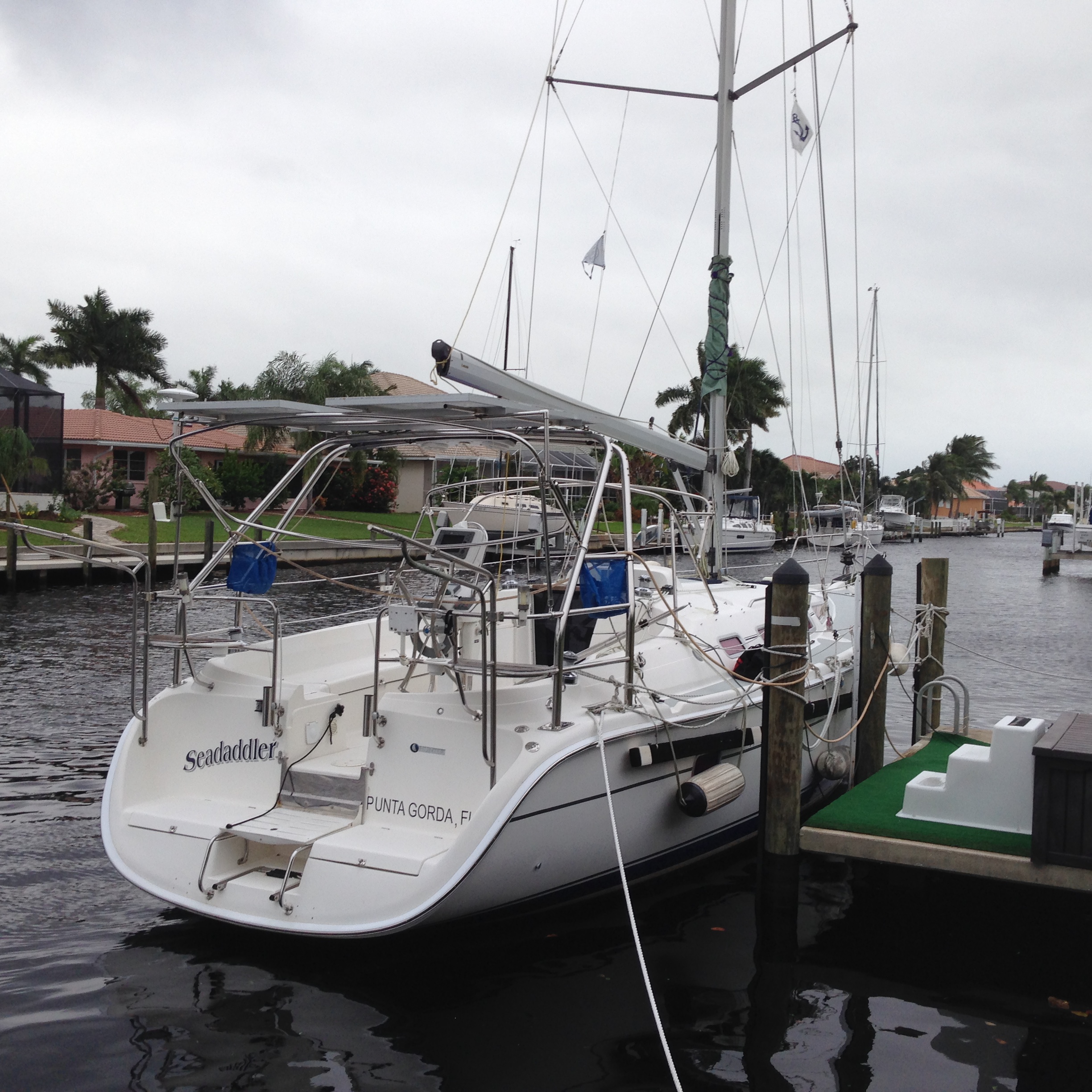

I did same on my 2007 H-36 and had the wires exit the rear port pipe bolted to hull
and had to drill another hole in arch at top arch near speakers for heavy wires
Ran wires to under nav station to my charge controller.
I have 2-195 wall panels over Bimini using the arch and one rear support of bimini.
