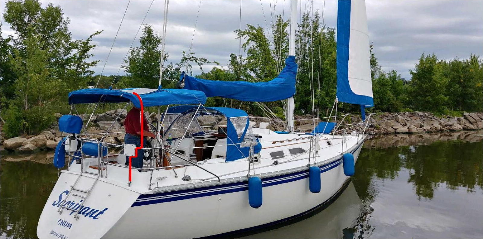

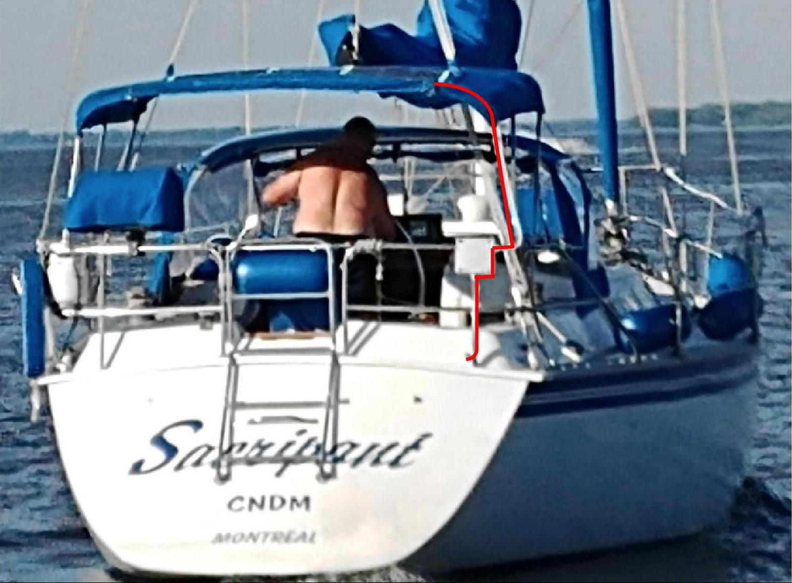

I have 2 X 100W flexible panels mounted on the bimini. Don't know if this helps you, but my bimini is set-up with SS back supports attached to the stern rail. So I ran the wire on the bimini to the starboard side, then down the back support, alongside the railing and the outboard motor support, further down the stern railing vertical support, then to a no-longer used telephone through-hull that I had right near that railing support. After wire was run through it, I plugged-up the telephone through-hull with caulking and ran the wire to the batteries in the locker. The pics will show you the routing of the wire in red.
Good luck with your set-up.
