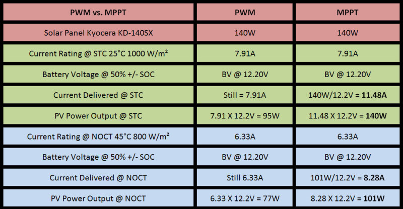

Solar panels are a current limited source but they are also rated at 77°F and 1000 watts per meter². With a really cool day and better than ideal or better than STC test conditions, it is possible for the panels to approach the Isc or short circuit rating. It would be quite rare for panels to exceed the Isc rating seeing as this is the rating the NEC and NFPA use for sizing over current protection and what is defined as the maximum short circuit current the PV array is capable of under ideal conditions.
The Kyocera KD-140SX is rated for 7.91A at 77°F & 1000 watts per meter² of irradiance. Its short-circuit rating is 8.68A at 77°F and 1000 watts per meter². If we multiply 8.68 X 3 = 26.04. This is still a long way from 29A and it is unlikely a 140W panel can deliver 9.67A, without an MPPT controller, even if short circuited.
Can you snap a shot of your panels ratings tag?
Here is a chart that shows some potential scenarios for PWM vs. MPPT
