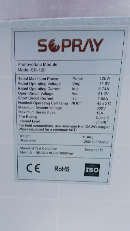

My house bank is 4 group 29 (Walmart), split in 2 of 2 (100 Amp Fused each), Main battery switch is always kept in Both. I have an Air Breeze generator , and 2 Sopray 120W solar panels with a C40 Xantrex controller. Wind and solar are connected in parallel to the "BOTH" terminal on the Main Battery switch.

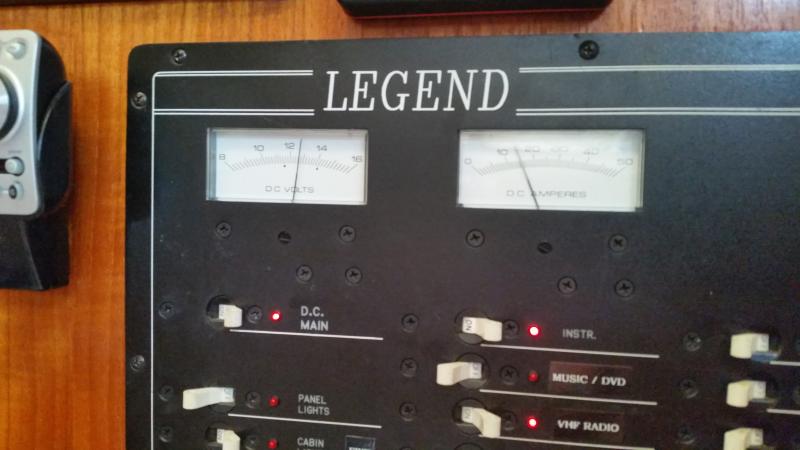

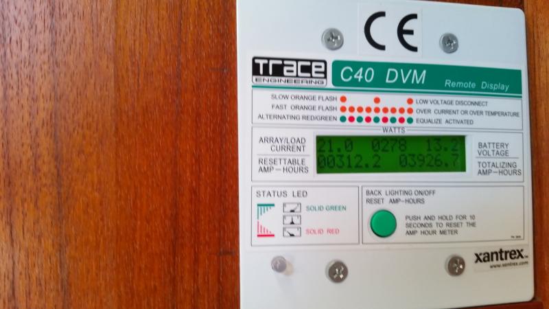

I do not have a Battery monitor yet. Here are the pictures taken then on the indications on the Xantrec remote panel and the Boat V and A meters. Is this 21 Amp expected to be normal?
I have seen them producing 13-14 amps in the Chesapeake bay, but is 21 Amps OK in the south?
Sailing east of Key West at 1:30pm on July 17, with light wind (5-7 kt) and sunny, Refrigerator, Freezer, autopilot, VHF, instruments and charplotter switches on. Engine was Off.
