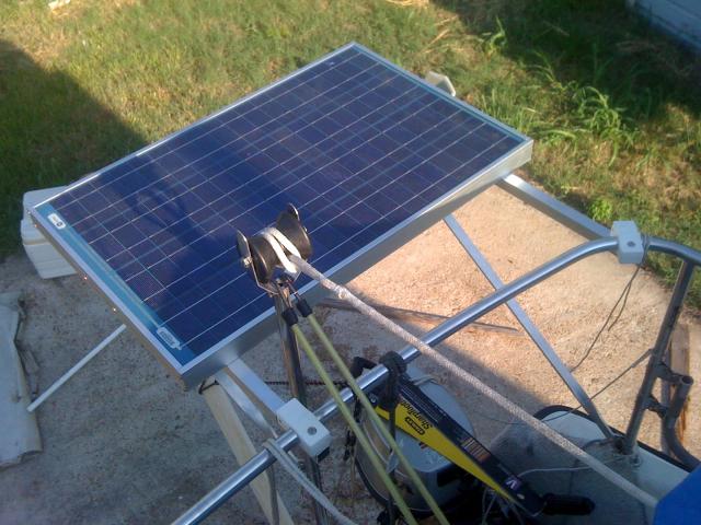

Here's a cheap and easy way I mounted a solar panel, (if you have life line stantions). Granted, it was a trickle charger, but it kept the battery re-charged and topped off while the boat sat on the trailer. Made with inexpensive 1" PVC pipe supplies.
