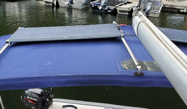

The panels are still only attached using a couple of loops of small line and bungees which criss cross the canvas on the bimini. I'm still planning on installing velcro around at least three sides of each panel. I found that charging dropped way off when the angle of the sun got low last fall, I think that I would like to be able to release one end of each panel so that they are not as curved, and end up being flatter relative to the sun.

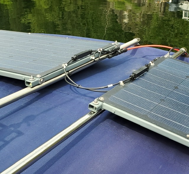

I installed on my B31 two semi-flexible 100W panels on rigid frames above bimini. Cables run along back Bimini tubing and enter the hull inside Life Raft compartment.
The frame for each panel is made from discarded fibreglass hockey sticks, providing light and rigid base for each panel. Each panel is attached to 1” OD SST tubes above Bimini fabric. In this design, I have room for future installation of additional two 100W panels (400W total). In winter, boat is covered, therefore Bimini and panels are removed.
Likes: SoSound

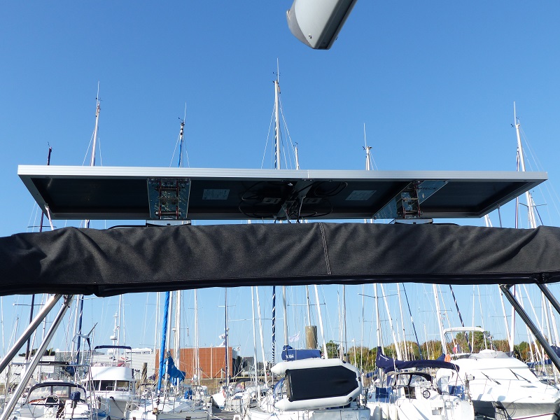

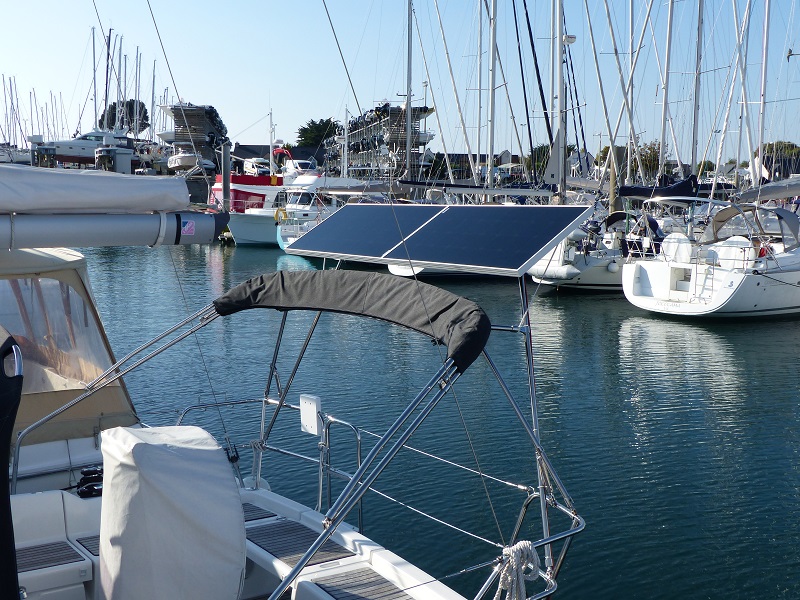

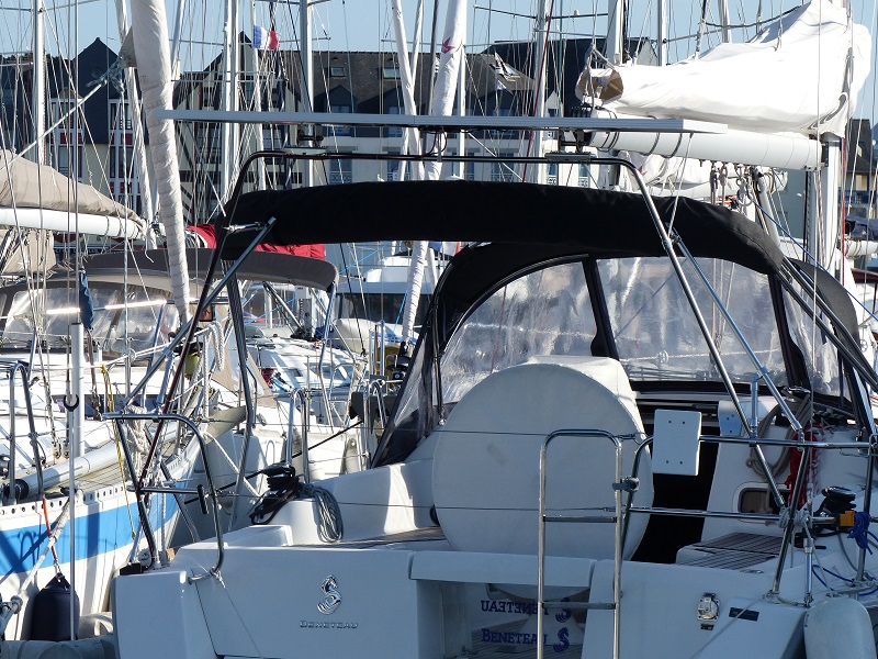

I installed 2 x 110W solar panels on my O31. They are mounted on orientable supports fastened on a monotube stabilized to the bimini structure.
The monotubing arch is hinged to the rear pulpit.
The overall installation looks quite light which is fine on a small boat.
Likes: SoSound
This looks like another good solution - many thanks for your advice and photos too.

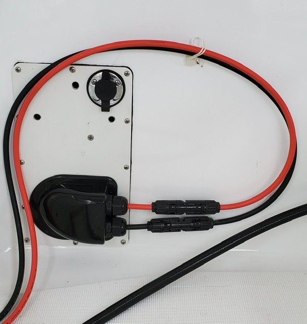

If you are trickle charging a 20 watt panel is sufficient. I got the panel, flipped it over and screwed two pieces of wood crosswise underneath after I had bolted these to the wood. This attaches the panel to the rail. The wires went down the SS tubing at the stern and the wire went through the back of the deck with what is called a "cable and deck connector". This has worked very well for me.

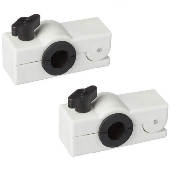

Thanks for your reply - I’ve not seen these rail clamps before, although I did notice some boats in the marina in winter with panels attached to the dodgers; the clamps look useful and presumably they can be set at an angle too. Agree that trickle charging wouldn’t need much but I’ll need to go for higher wattage as I need more autonomy particularly in the use of the fridge (I currently switch it on when motoring but then off when at anchor and the voltage drops too low; with a couple of frozen bottles of water to begin with the temperature remains correct for a couple of days). I loathe running the engine just for charging and it’s surprising how much the water pump needs when it kicks in; fortunately heating is not needed at the moment.

Those rail clamps are very strong. There is rubber where they meet the rail. You can loosen the wingnut and adjust the tilt. They would be capable of supporting a good sized panel, and you could always fashion a strut going back to a tube.
