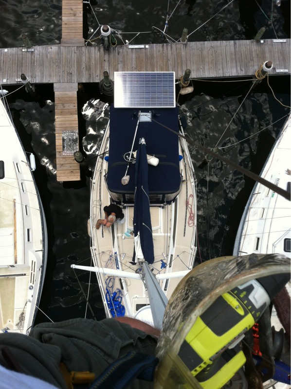

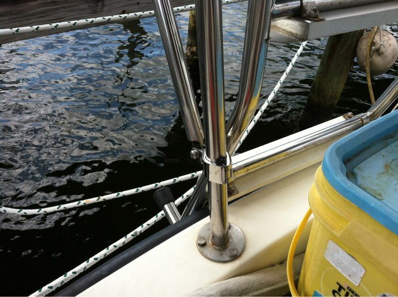

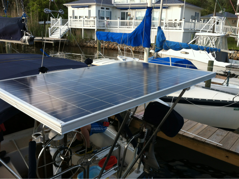

First let me say I have the great fortune of having a father-in-law that can weld, do AC work and generally fabricate most of what I can come up with. With that said this is the upgrade to my original solar panel install. My first panel was 135w kyeosera 12v panel. It was 39x24 and sat in the same place.

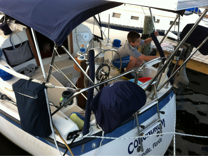

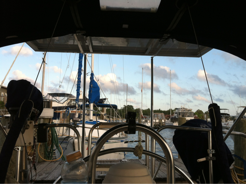

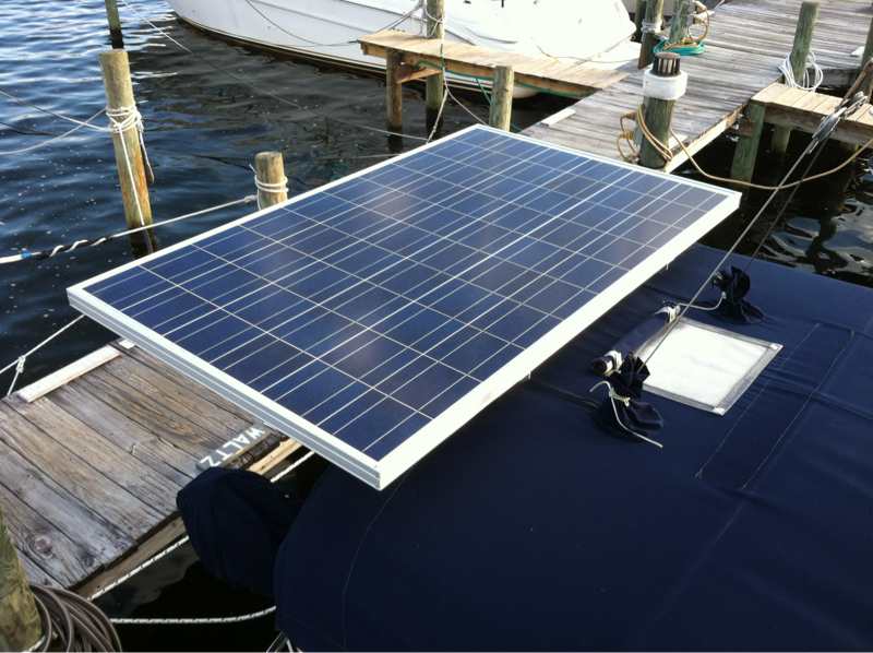

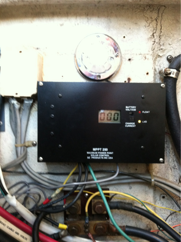

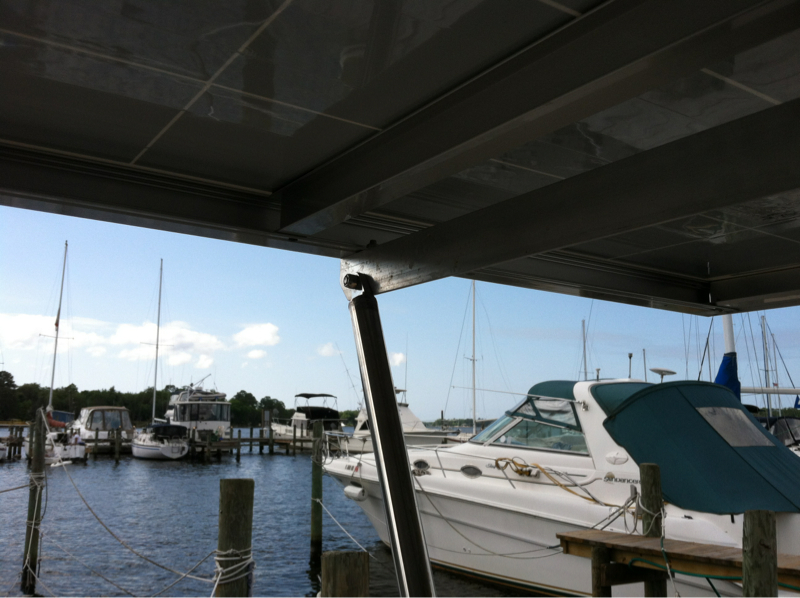

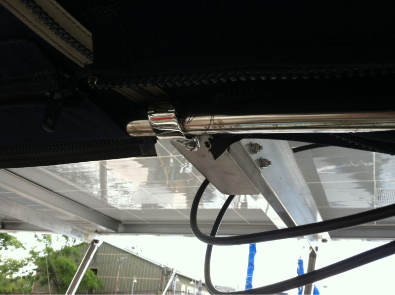

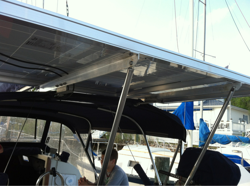

After some testing I decided I wanted more power to handle charging the kids potable devices and the like. The panel shown is a Sharp 230W panel @ 24v. I have that connected to a BZ 250w MPPT charge controller. The charge controller will step the 24v down 12v doubling my charging amps. So far it's been amazing. My house bank is composed of 4 Trojan T-105 6v batteries. I'm normally at float by 10am right now. The panel is big. It's 66"x 39". I have about 10" coming back over the top of the Bimini. The big advantage to that location is added shade and protection from rain, as well as it not getting shaded by the mast. Do far it's been working great. My kyeosrra was a bit more efficient in low light but not enough to matter. Panel was $288 at solarblvd.com. Plus $106 for the charge controller. $100 bux to ship. I have converted all my lighting on board to led that we built or converted ourselves do other than refrigeration my power consumption is low. Overall I'm very happy. I do have a link 20 to install to replace my link 10. The charge contrast also has a seperate circuit for a trickle charger for the engine battery. I'm not using that. Because I have a path finder installed. All the support brackets are custom built and welded but could easily be made with the screw together type
